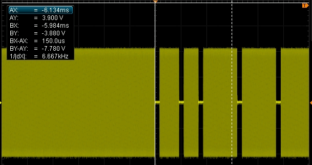

  • This setup demonstrated collision avoidance. Thanks, that's my primary want.
    When I change the calls TRF79xxA_setupInitiator(0x02) to TRF79xxA_setupInitiator(0x00) (in iso15693.c & nsf_app.c) output modulation still is at the 26 kbps rate, rather than the expected 6.6 kbps.  Are there other places in the code I need to change configuration?
  • Hello Mark,
    I can clearly see now I did a terrible job communicating the changes required. Sorry.
    By "Adjust the TRF79xxA_setupInitiator call to account for low data rate" I had meant the function itself because low rate is not a covered case for it. So you'd need to adjust the actually API in order to add a new case, and then have the right ISO control register setting called.
  • I neglected to note I did go into TRF79xxA_setupInitiator() and set it up to respond to ISO Control register setting 0.
    Further experimentation found I can change modulation between AKS/OOK and 1:4/1:256 encoding. Still, no change to modulation rate.
    Setting a breakpoint on SPI_writeSingle(), I didn't see evidence of gremlins overwriting ISO Control.
    Nothing in the Errata suggests issues with 6.62 kbps.
    Perhaps I'm missing something with register settings.  Are there other register changes needed along with ISO Control?

    	// msf - 8/19/19 - Different configurations
    	//TRF79xxA_setupInitiator(0x02);		// Configure the TRF79xxA for ISO15693 @ High Bit Rate, One Subcarrier, 1 out of 4
    	//TRF79xxA_setupInitiator(0x03);  //ISO/IEC 15693 high bit rate, 26.48 kbps, one subcarrier, 1 out of 256
    	TRF79xxA_setupInitiator(0x00);		// Configure the TRF79xxA for ISO15693 @ Low Bit Rate, One Subcarrier, 1 out of 4
    	//TRF79xxA_setupInitiator(0x01);  //ISO/IEC 15693 low bit rate, 6.62 kbps, one subcarrier, 1 out of 256

  • I changed the two locations where I found TRF79xxA_waitRxData(5,15) in iso15693.c.  Still no luck.
    If I'm reading the modulation correctly off my 'scope, it still looks like 26.5 kbps.
    Maybe I'm suffering from version misalignment.  Perhaps if you could send your copies of trf79xxa.c & iso15693.c, I can compile them here.
  • Hello Mark,
    You need to adjust the timeouts for all calls of TRF79xxA_waitRxData in the ISO15693 file. I just showed one example. The timeouts are all customized based on the function.
    Here's the whole project I used, it's from my test branch so I don't remember if there were other changes I made so just verify that it works and then pull over what you need that is ISO15693 specific: TRF7970ABP_RFID_Reader_Demo_Low_Data.zip
  • Ralph,
    Indeed, the reader does now work with tags.  However, if I'm reading my 'scope output correctly, it still looks like 26.48 kbps. The cursors below are 150us apart.
  • Mark -
    I think you have a misconception that the ISO15693 downlink will ever occur at 6.62kbps...this, the setting of 0x00 from 0x02 (for the TRF79xxA ISO Control Register) is for the part to know (ahead of time) then what the reader is sending out in the down-link message with the matching request flags to the tag.
    To be clear - the downlink will always be (should be anyway) at a high ISO15693 data rate for low power HF RFID readers . (unless you really want to use pulse position, which would drop you to 1.6kbps, which is the other option on the reader side, not 6.62kbps), 1 of 4 data coding should always be used.
    Request flags bytes to use here are:
    single subcarrier, low data rate, single slot inventory: 0x20
    single subcarrier, low data rate, sixteen slot inventory: 0x00
    single subcarrier, high data rate, sixteen slot inventory: 0x06
    single subcarrier, high data rate, single slot inventory: 0x26
    etc.
  • Josh,
    Thank you for the clarification.  These "standards" include bewildering variations.
    Having demonstrated software for collision avoidance and external modulation control, I'm venturing out on my own, designing a new Class E amplifier for this chip!
    -Mark Freeman
