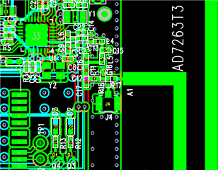

We did put the TVS and still we have over current problems
Not optimal placement but should help some.
On a failing and good board, please measure the impedance from each pin to ground and list the pin(s) where you clearly have a short.

I would like to note that the CC1310 still working but the RF IC part doesn't working

I was referring to the pin impedance. What we typically see with a ESD damaged device is very low impedance to ground from either the VDDS pins or RF pins.
I assume that you see a high current draw independent of what you are running on the MCU?
If you take a new board, connect JTAG, is the current consumption normal then?
Not sure. 400 mA indicate a very low impedance between VDD and ground. But from the impedance measurements you did does not indicate that this is not in the chip. This doesn't add up.
it is inside the IC - when we replace the IC it is goes back to normal current

It's not possible to get the chip to use 400 mA writing code, this is HW malfunction due to external overvoltage.

with 400 mA current draw you have a ESD damage but the impedance numbers you have presented doesn't indicate which pin and without that information it's not possible to find out what you have to do to fix that issue.
