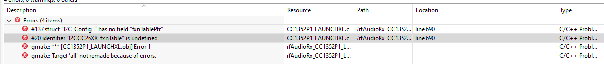

    Now this works too, but I got the error following error messages when building the project.
    And in fact, the I2C_Config struct has no field .fxnTablePtr in my version of the I2C driver.

  • See the post I referred to, I have included in that how the I2C needs to be changed, try search for I2C.
  • Hi TER,
    sorry, I failed to update you on this error. After my last reply, I deleted the line
    .fxnTablePtr = &I2CCC26XX_fxnTable
    just like you did in your referred post. This at least resolved the compiler errors. But now I have many linker errors (76 in total) with many unresolved symbols from the modules ClockP, GPTimerCC26XX, HwiP, I2C, List, PIN, Power, Semaphore and SwiP. Also, there are files missing, as shown in the image below.
