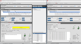

Hi team:
The 4FSK was designed for testing on both evaluation boards and no location was found for setting 4FSK. Can smart RF be set?
Also, in the default 2GFSK rate, the transmit and receive works fine at 600K rate, and at 700K rate, packet loss starts, but RSSI only -43 dBm, so why do you get packet loss?
Best regards
Alex
