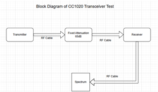

    Are you measuring the RX Sensitivity according to the recommended test procedure in SWRA370 (Basic RF Testing of CCxxxx Devices): https://www.ti.com/lit/swra370 ?
    Please can you outline your test setup?
    Zack
    Thanks for response. I have attached test setup for your reference and unmodulated carrier power is -28dBm. So, if 65 dB attenuation is given between Tx & Rx path, the received power level at RF in of transceiver to be considered is -91 dBm but in datasheet it was mentioned -112dBm. I have configured both synchronous NRZ mode with 4.8kbps data rate and tried to change VGA settings, deviation and loop filter values to 12.5KHz & 25KHz channel spacing.

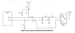

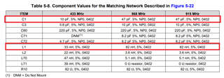

    The next step would be to double-check the LNA input matching network, described in Section 5.11 of the CC1020 datasheet:
    What is your frequency of operation? We would be interested in checking the values of L1 and C1:
