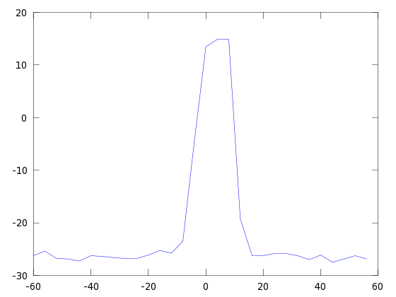

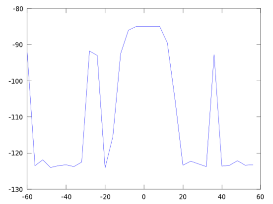

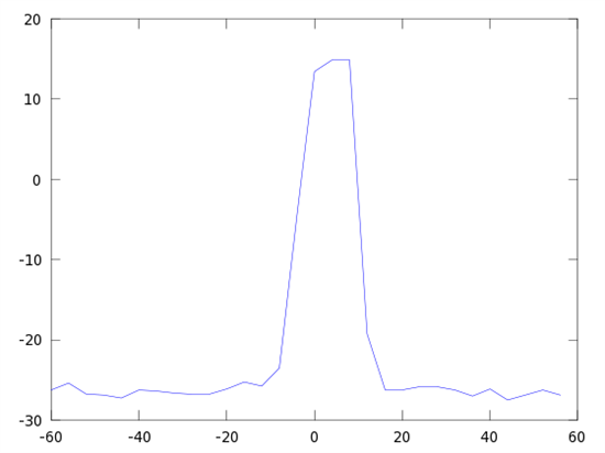

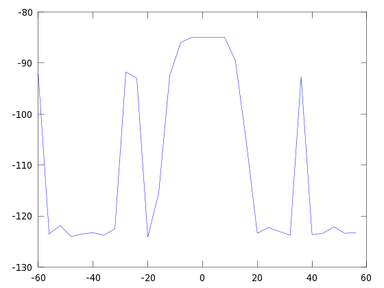

    The receiver needs to perform a frequency correction for the LO offset, so far I'm trying to use the RSSI value for it. The graph inside/below shows the frequency offset in kHz and the RSSI value in dBm. This uses the 8kHz filter and the frequency stepwidth is 4kHz. The odd thing is that despite the programmed correction value in AGC_GAIN_ADJUST the result lies around -34dBm. The signal level is currently set to -80dBm @ 869.21250MHz

    Somehow I'm not sure now how to properly set lower bandwidths, what did I miss? Anyway thanks for the suggestion, I feel much better now. The signal I'm using is just a CW signal btw.
  • I used a working 8kHz BW setup from RFStudio in my setup and was able to get a useable result with the same input as before. There is no  RSSI correction in place yet but the 40dB I was expecting I do get.
