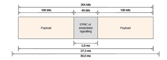

  • Hi TER,
         The following is frame format, for your reference. so do you think CC1125 can support this sync mode?
             If without sync, how CC1125 to do demodulation?
             About oversample, for my case, one symbol just one deviation, How can I do symbol sync? before I can do demodulation, I have to do frame sync and symbol sync firstly, so oversampling is necessary!

  • Just to clarify : Is it no preamble or sync before the first 108 bits of payload? How do you know you receiving payload and not noise? (regardless of the method you are using to receive the data)
  • Hi TER,
         No, there are no preamble or sync before the first payload.
         So, First, our MCU received the oversampling raw data and buffer one frame, then do sync and demodulation, and  then high layer process!
        Br
    Haibo
  • Is the same payload sent twice? CC112x needs to receive a few bits to settle the AGC before receiving data.
