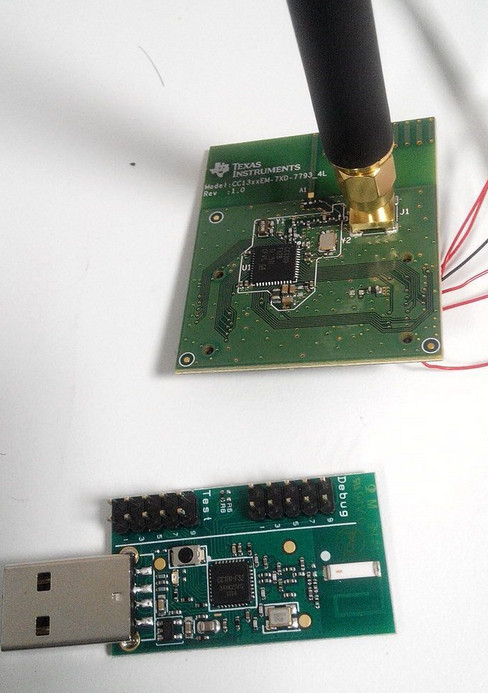

Hi, I have already bought CC1111 USB Evaluation Module Kit 868/915 MHz (www.ti.com/.../cc1111emk868-915), and  SimpleLink™ Sub-1 GHz CC1310 Evaluation Module Kit (www.ti.com/.../CC1310EMK), as shown below.

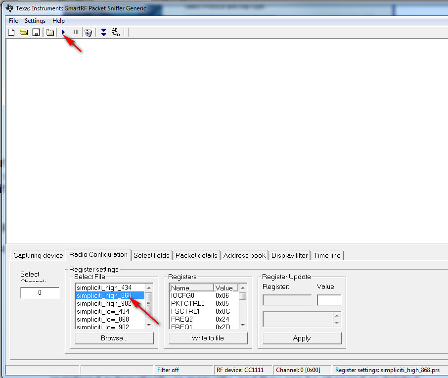

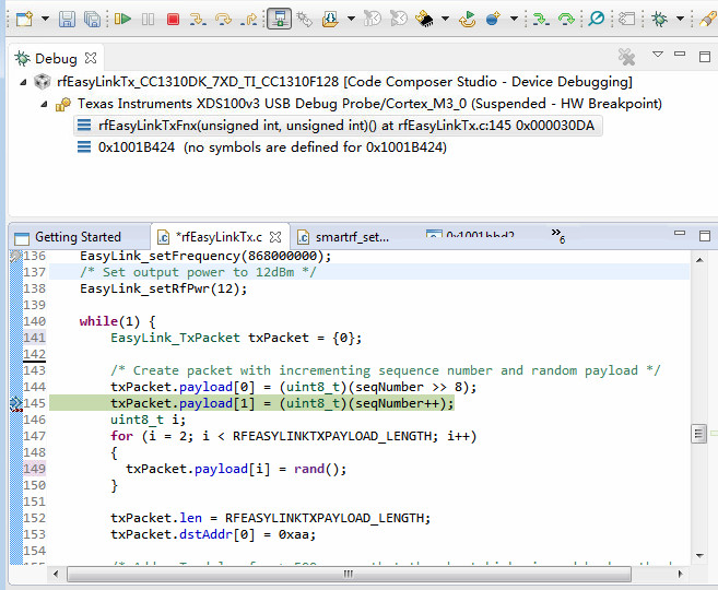

I am trying to run and debug the example project provided by TI. This project is shown below
I find that CC1111 USB Evaluation Module Kit 868/915 MHz cannot receive any data packet.
Could some one provide some instructions about how to receive the packet from CC1310 by using CC1111 USB Evaluation Module Kit 868/915 MHz?

    I open the file "simpliciti_high_868.prs" provided by the software, as shown in the above figure. The content of this file is

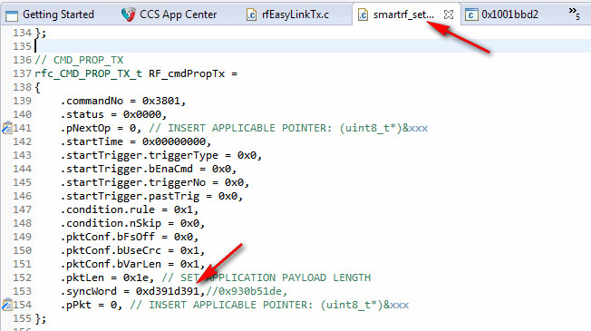

  • If SYNC1/SYNC0 is not set in the Packet sniffer settings you list the syncword is set to the default which is 0xD391D391
  • Hi, thank you very much. Could you tell me how to modify the code in the project as shown below to make the  syncword in CC1310 be 0xD391D391. I am a newer for TI CC1310 and I hope to get the right running results first and then study the example code carefully. Thank you.
  • The examples uses two files named smartrf_settings.c and smartrf_settings.h. These you can use smartRF Studio to generate. So if you want a different sync word, open SmartRF Studio, type in the sync word you want to use in the GUI and do a code export. Or do a search in the smartrf_settings.c file in the example after .syncWord and type in the sync word you need here.
  • Hi, I have modified the sync word of CC1310 through changing the file "smartrf_settings.c", as shown below

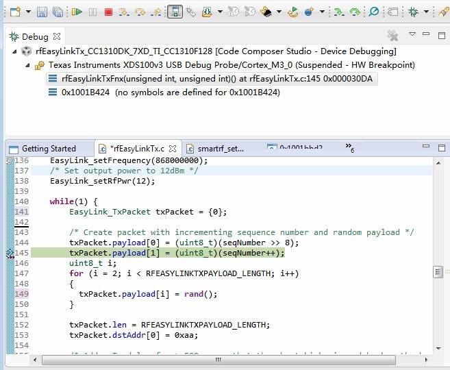

    then, I clean the project and rebuild it, and debug it. I can debug it into the while loop for sending packet out, as shown below

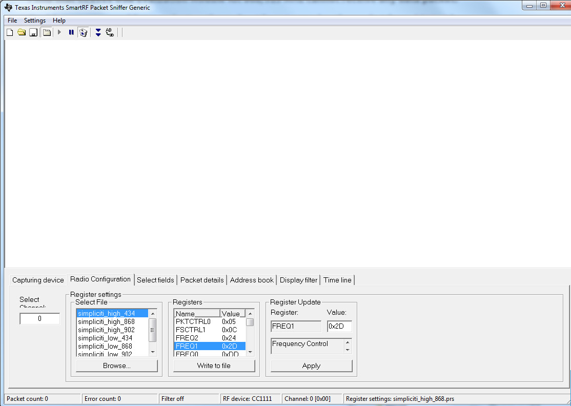

    I then open the software, TI SmartRF Packet Sniffer. I choose “Generic”, as shown below

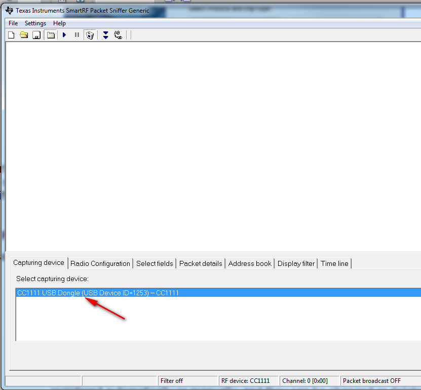

    Then, I choose the capturing device, as shown below
    Then, I choose the register settings and click the run button, as shown below
    I find that I still cannot receive any packets from CC1310.
    Of course, the breakpoints inside the while loop have been removed and the code runs continuously.
    Is there something wrong in my settings? Except those steps stated above, other settings are left in their default settings. I just open the box and use them.
    Thank you.

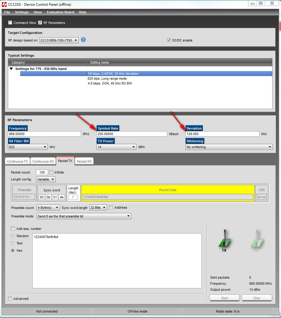

  • As you see from the datarate in the list you are using 250 kbps on CC1110 and 50 kbps on CC1310. They have to be equal.
  • Hi, I changed the datarate in CC1310 to be 250 kbps and the deviation in CC1310 to be 129 KHz, as shown below
    these hex values are found from the code generated by SmartRF Studio v7. The settings of this software are set as shown in the figure below,
    Even after making the symbol rate and deviation of CC1310 be the same as that in CC1111, I still cannot receive any packet in CC1111 USB Evaluation Module Kit.
    How to solve this problem? Is there something else that I forget to change?
