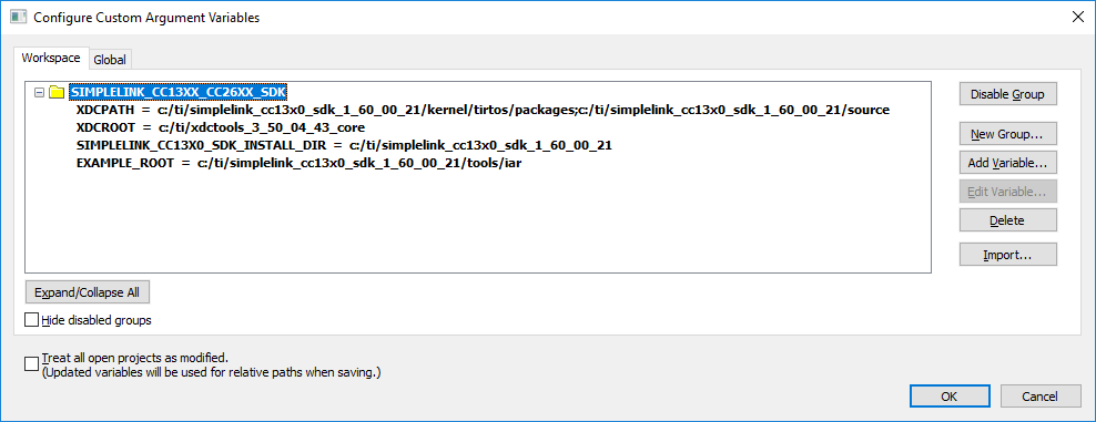

  • I tested my project with the same Build action configurations that you used and I get no error. What steps did you follow when importing the project?
    After selecting the correct Arg. Variables like shown below:

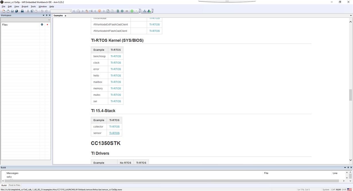

    Just a comment: From one of your plot it seems like you have opened the sensor_cc13x0lp.eww in the default location in the SDK (C:\ti\simplelink_cc13x0_sdk_1_60_00_21\examples\rtos\CC1350_LAUNCHXL\ti154stack\sensor\tirtos\iar). Is this correct? I would strongly recommend that you import it from the Information center instead as described here:
    dev.ti.com/.../tidrivers-quick-start.html

    From the error logs it seems the project path contain spaces: C:\Users\Deepak Chopra\Documents\check\....
    Could you please try to build the project from a location that does not contain any spaces in the path? I am not sure if it will help, but at least then we can rule out that as a problem.
    Bjørn
                 I try with different project location without space,it's also give same error.Please check attach error file.
    Building configuration: sensor_cc13x0lp - Debug
