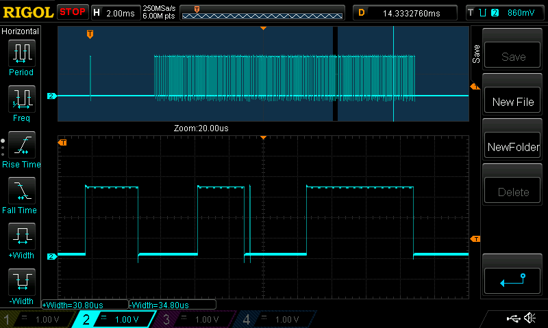

I am using SmartRF Studio V2.10.0 with a CC1350 Rev 2.1 (Rev. B) launchpad. If I configure the symbol rate higher than 14.5kbps the CC1350 sends out a single packet and then does not send any subsequent packets. Even if I lower the symbol rate to 4.8 kBaud after attempting higher than 14.5 kbps. Only if I close and open the Device Control Panel for the launchpad will it work again.
Steps to reproduce:
  • Open CC1350 launchpad in proprietary mode.
  • Select Legacy CC11xx settings
  • Select 4.8 kbps, OOK
  • Change Frequency to 433.92Mhz and symbol rate to 15kbps
  • Start transmission
The first packet will send correctly and then no other packets will send.
