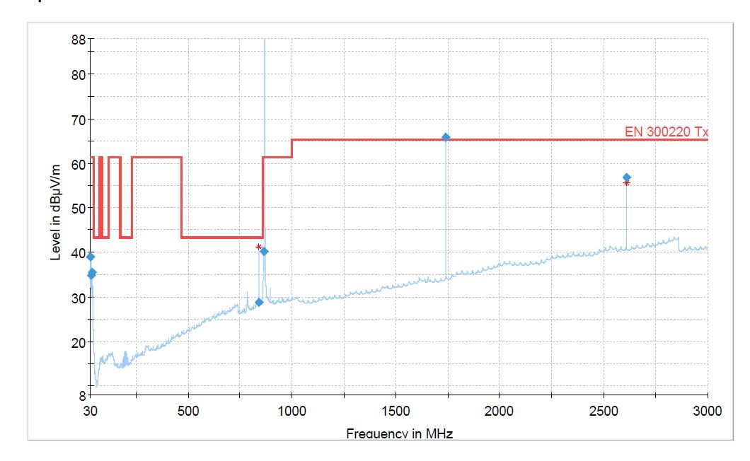

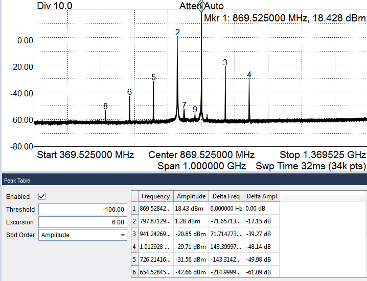

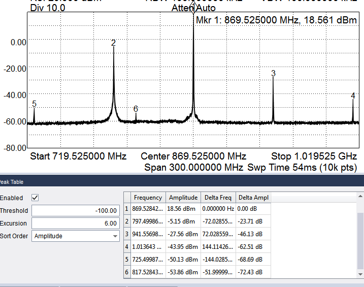

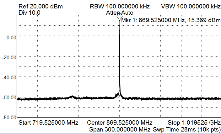

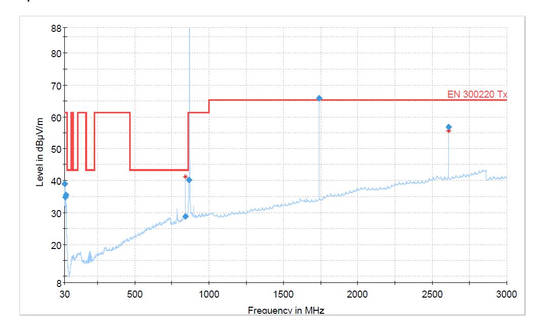

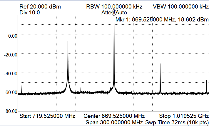

I am using the CC1120 + CC1190 for both transmission and reception. I have used the CC112x-CC1190 BoosterPack Reference Design SWrr145a for my design. I am transmitting at 869.525 MHz. My maximum power needed is 500 mW (+27 dBm). Now I have a problem. When I configure the CC1120 register PA_CFG2 to a higher value than 0x5A it seems that the something, maybe the CC1190, is overdriven and I get a lot of spurious frequencies. What can be the problem? Enclosing the schematic diagram. R22,23,27, C57, D6 is not mounted.
