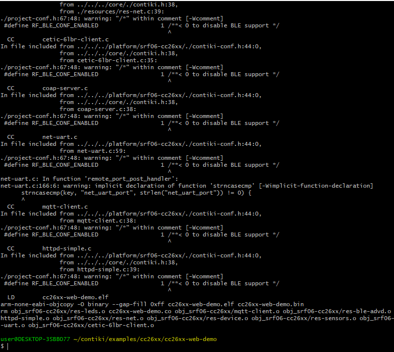

  • When I rebuild again I noticed this:
    As you see there is:
    #define RF_BLE_CONF_ENABLED            1
    despite I setted this #define to 0.
    How can I do?
  • Can you attach your project-conf.h?
  • I found the error that was an instruction not commented but despite rebuild it the putty there is still BLE: YES.
    However it s my project-conf.h

    How can I do?
  • Change
    #ifndef RF_BLE_CONF_ENABLED
    to
    #define RF_BLE_CONF_ENABLED 0
  • I changed how you told me and I rebuild but BLE:Yes.
