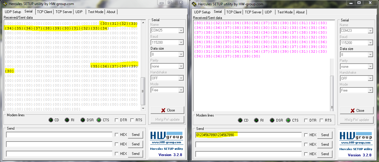

  • I write a software for the communication between two cc1310. If I write to first device I receive the message for to second device. In my code, the payload is set to 30 byte for default. I try to change the .pktlen in smartrfsettings.c to 1e in 32..but not working

    If I send 20 charcacter then 40 byte, I see the first packet 30 byte and the second packet with 10 byte. Can I read all in one packet?

  • No, I set MAX_LENGHT 125. On the port serial I see this:
    COM1: I send 20 characters(40 byte) =01234567890123456789
    COM2: I receive:
    01234567890123400000(up to the whole package 125) and 567890000000000000000000000000000000000(up to the whole package 125)
    I send 40 byte, but I receive the first packet with 30 byte(15 characters) and the second with 10 byte(5 characters)

  • Hi TER, I can't send you the code, because it is of my company. I attached here the capture of my port serial. In this moment the my communication accept 30 byte(15 characters), but if I send 20 byte (20 characters) I see two packet (see photo)

  • Yes, I receive two packet on the serial output.
    This is the RX packet on my code:
        		UART_read(uart, &From_RS232, sizeof(From_RS232));			/* Read max 30 byte */
