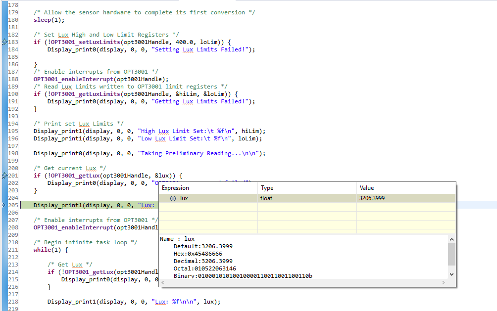

I am trying to run the CC1350 launhpad example with Sensors devpack.
I am successfully reading Lux from the sensors dev-pack using TI driver i2copt3001.c
However, I do not manage to get to interrupt. I've put breakpoints in interrupt handler and replaced:
GPIOCC26XX_DIO_15 | GPIO_DO_NOT_CONFIG,
With:
GPIOCC26XX_DIO_15 | GPIO_CFG_IN_INT_RISING,
And added the needed structures to CC1350_LAUNCXL.c:

  • Are you trying to trigger on a lux signal? Does it get high enough to trigger an output? Have you tried just a digital read?
    Yes
    Yes - I measured
    Yes, I can read from the device
    As you can see in the picture, I set high limit to 400.0 and measured 3206.3999. Still I don't get any interrupts...
  • Could you please specify which example, which lines you are modifying in which files?
    I looked at the code for the OPT3001 in and in the board file I found
    #ifdef BOOSTXL_BASSENSORS
    #define OPT3001_INT_PIN GPIOCC26XX_DIO_27
    #else // BOOSTXL_SENSORS
    #define OPT3001_INT_PIN GPIOCC26XX_DIO_15
    #endif
    indicating that DIO15 is actually in use in this example
  • Hi.
    I also used DIO_15 for my example. As I mentioned in my original post:
    1
    With:
    1
    With your post I looked in CC1350_LAUNCHXL.c and found that it is also using DIO_15, but in the example project there was also:
    GPIO_PinConfig gpioPinConfigs[] = {
        OPT3001_INT_PIN | GPIO_CFG_IN_PU | GPIO_CFG_IN_INT_FALLING,
    So when I changed
    with
    GPIOCC26XX_DIO_15 | GPIO_CFG_IN_PU | GPIO_CFG_IN_INT_FALLING
    I managed to solve it and stop at breakpoint inside the interrupt routine.
