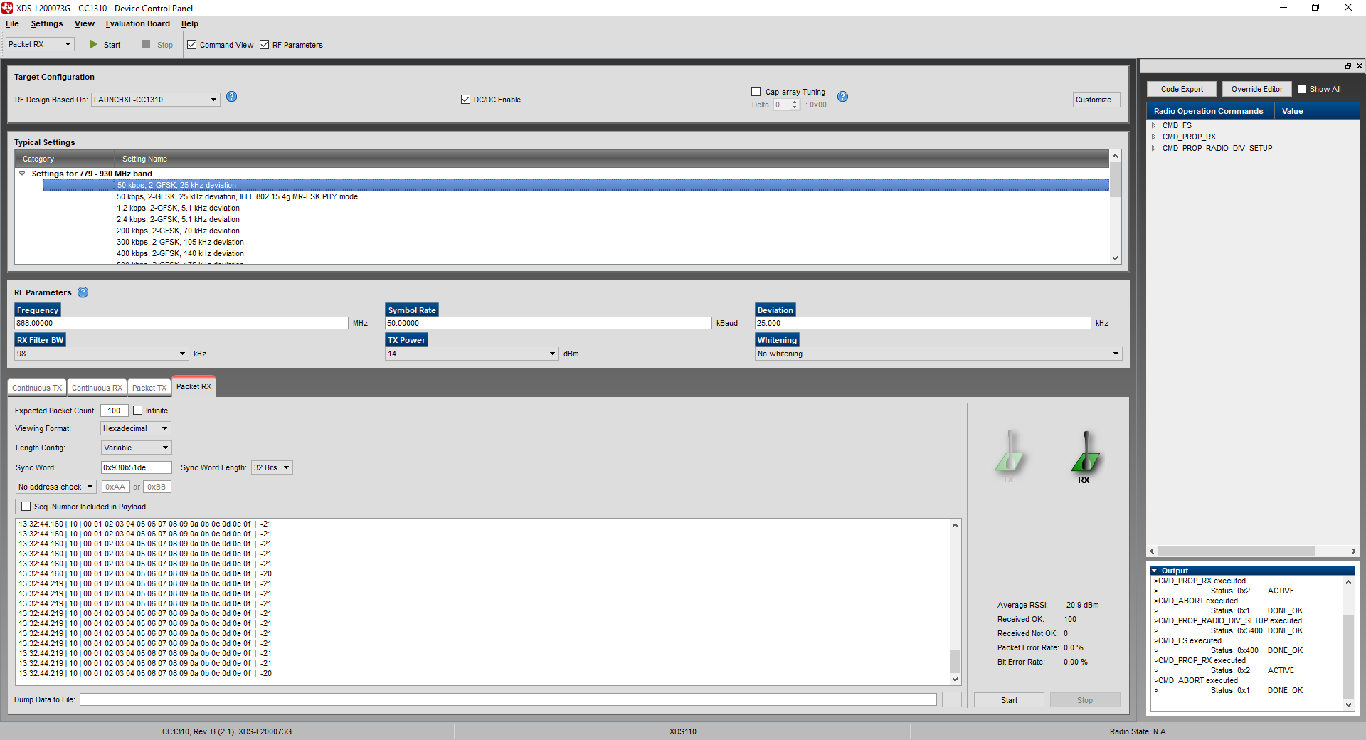

  • I took the rfPacket TX example from the latest SDK and replaced the rfPacketTX.c file with the following:

    I could receive all 100 packets with SmartRF Studio.

    I changed the TX packet to be 16 bytes instead of 1:
    static uint8_t packet[] = {0x55, 0x55, 0x55, 0x55, // Preamble
                               0x55, 0x55, 0x55, 0x55, 0x55, 0x55, 0x55, 0x55, 0x55, 0x55, 0x55,
                               0x93, 0x0B, 0x51, 0xDE, // Sync Word
                               16, // Length byte
                               0x00, 0x01, 0x02, 0x03, 0x04, 0x05, 0x06, 0x07, 0x08, 0x09, 0x0A, 0x0B, 0x0C, 0x0D, 0x0E, 0x0F, // Dummy payload
                               0x90, 0x0E, // CRC
    I received all packet with SmartRF Studio.
