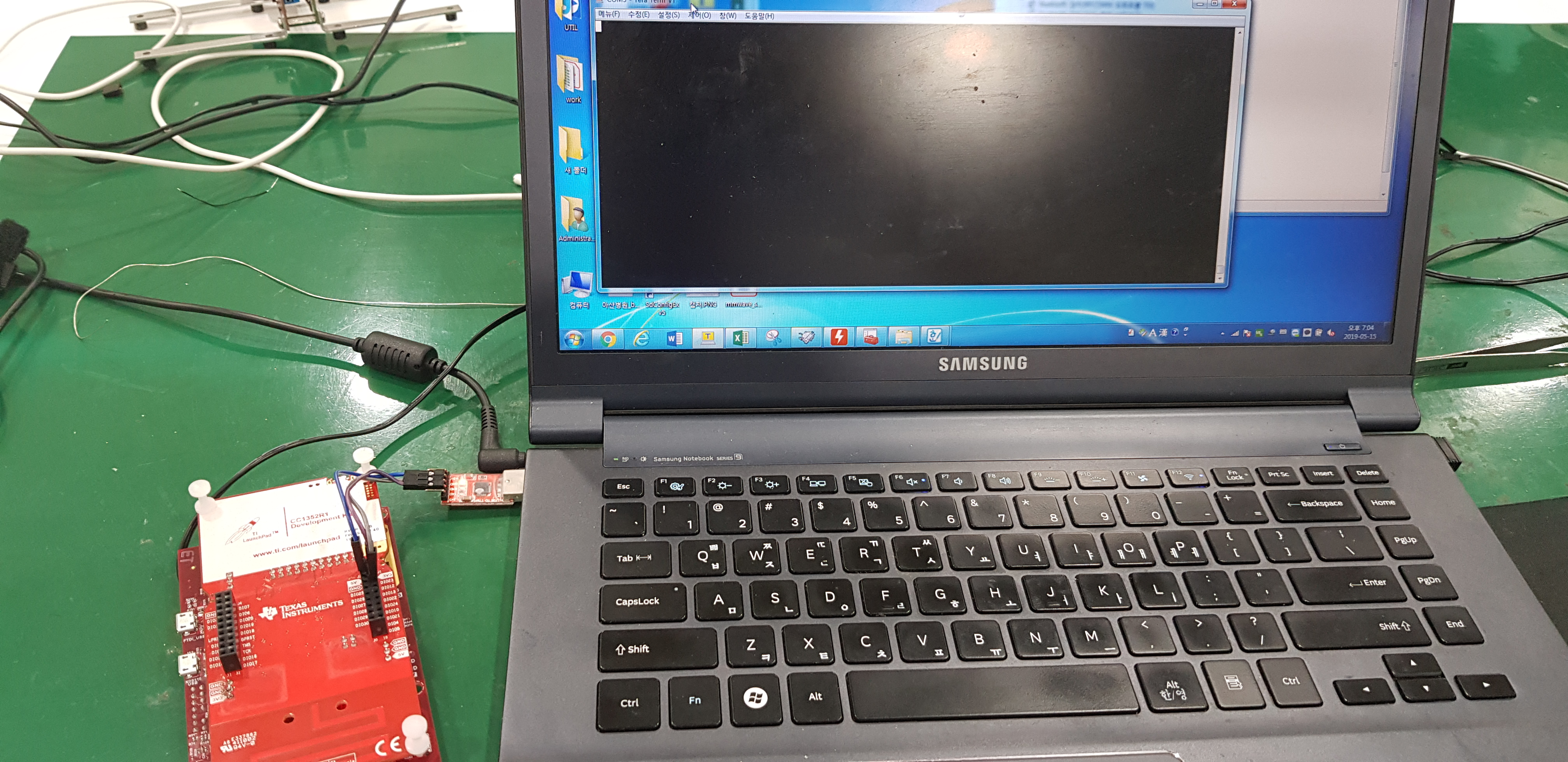

The cc1352r1 sensor node does not send commands to the iwr6843isk. What should I do?
I connected in the same way TI answered and confirmed that cc1352r1 did not send a command.
https://e2e.ti.com/support/wireless-connectivity/sub-1-ghz/f/156/t/801437
dio12, dio13
Nothing is output.

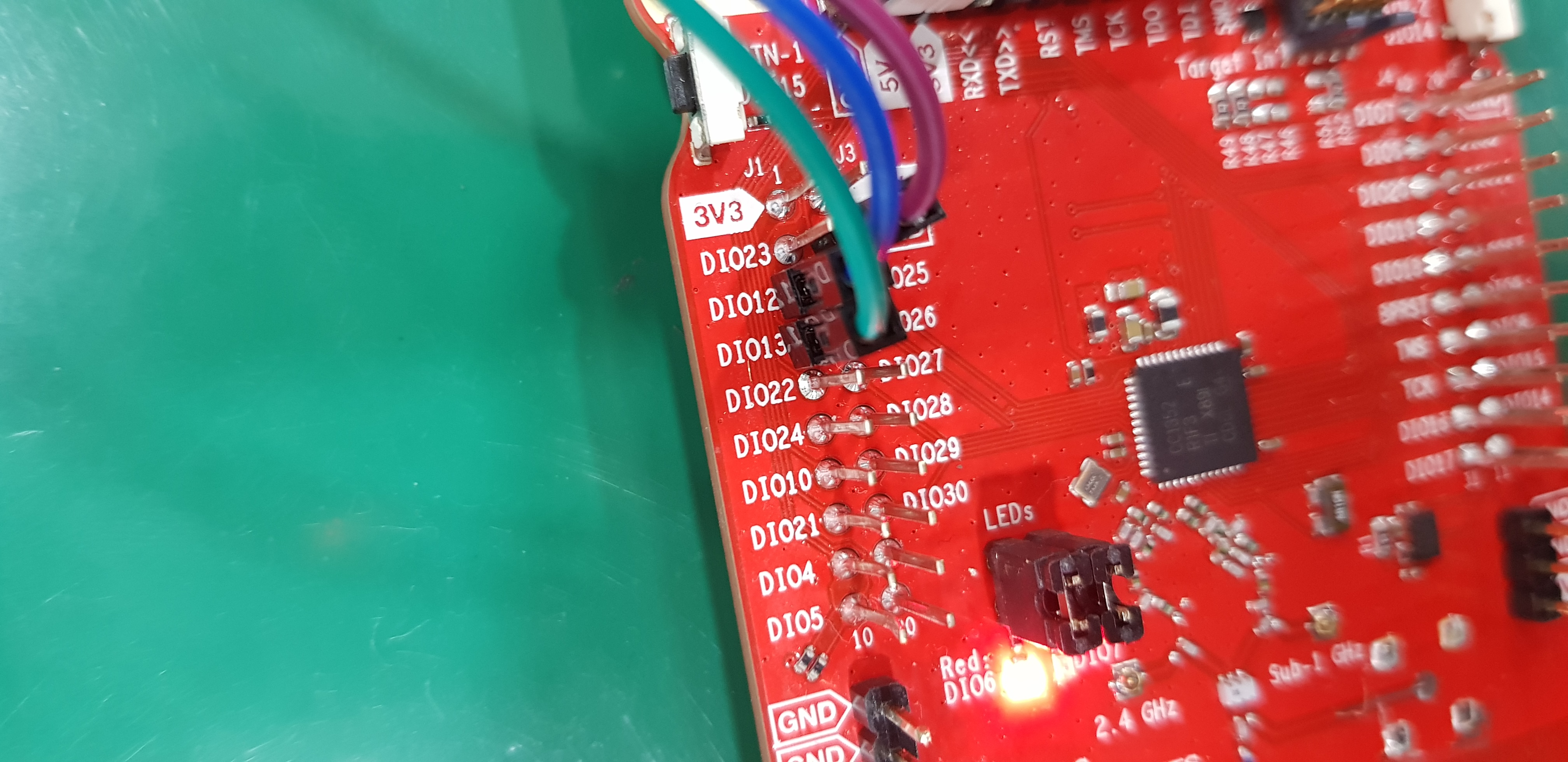

We also tried pressing nRST button and confirmed that it was connected to the connector node.

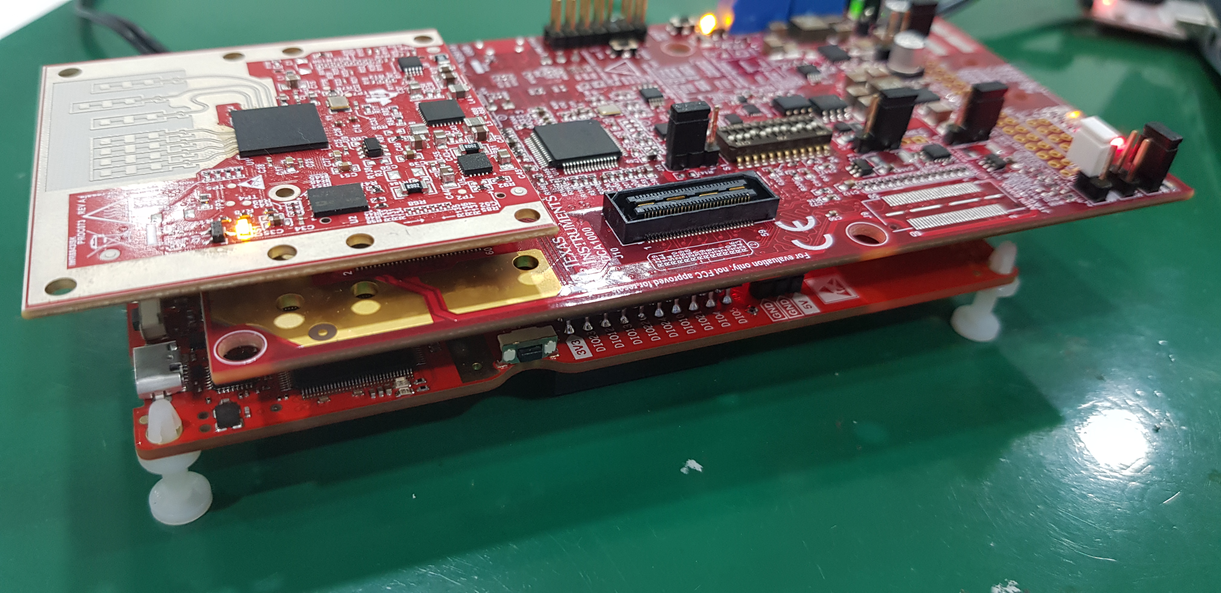

I connected the iwr6843 and cc1352r1 like the picture.
How do I debug cc1352r1 in this state?
I want to debug the part where cc1352 sends command to iwr6843.

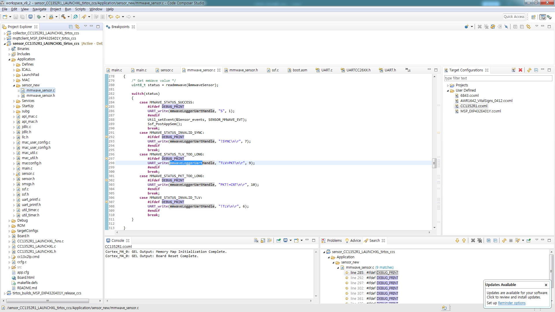

Define DEBUG_PRINT from the code in this example. How can I read mmwaveLoggerUart?

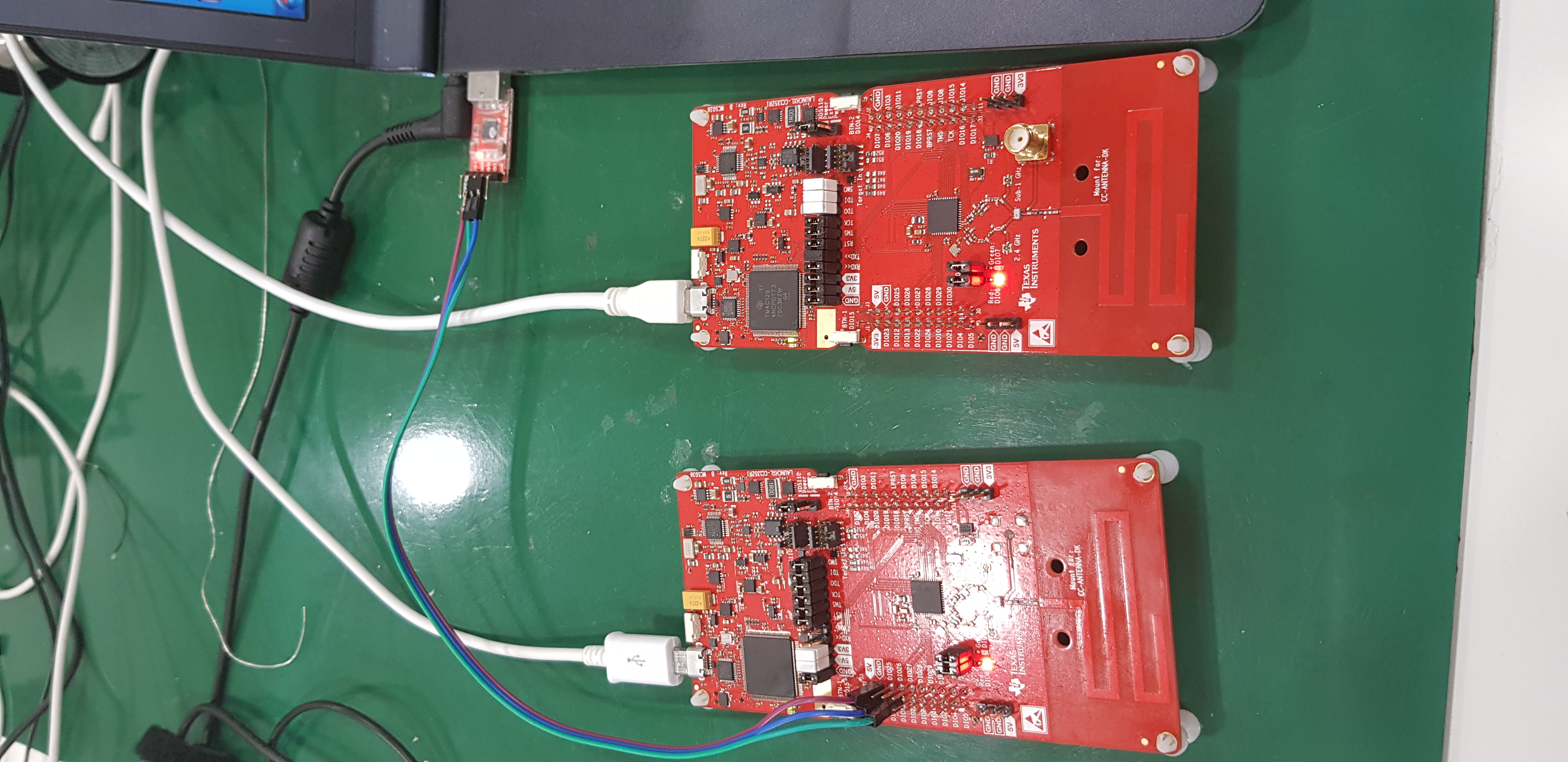

    To verify that the CC1352 is sending the configuration commands, you can do the following:
    • Flash mmwave collector code to one CC1352
    • Flash mmwave sensor code to another CC1352
    • In the sensor board, DO NOT connect the mmWave EVM
    • Probe UART0 on CC1352 sensor board
    • Power on both CC1352 launchpad
    • Pair sensor to collector
    • Wait 30 seconds
    • Check UART0 output
    • You should see "dfeDataOutputMode 1" printed on the screen.  It will stop there, since the mmwave is not connected.
      • If you see the output, that means the cc1352 is sending out commands. Check Section 3.1.1 (Hardware setup) for more information on how to pair the CC1352 and IWR6843
      • If you do not see the output, then make sure the sensor is paired to collector, you are probing the correct UART pin, and you have waited 30 seconds.

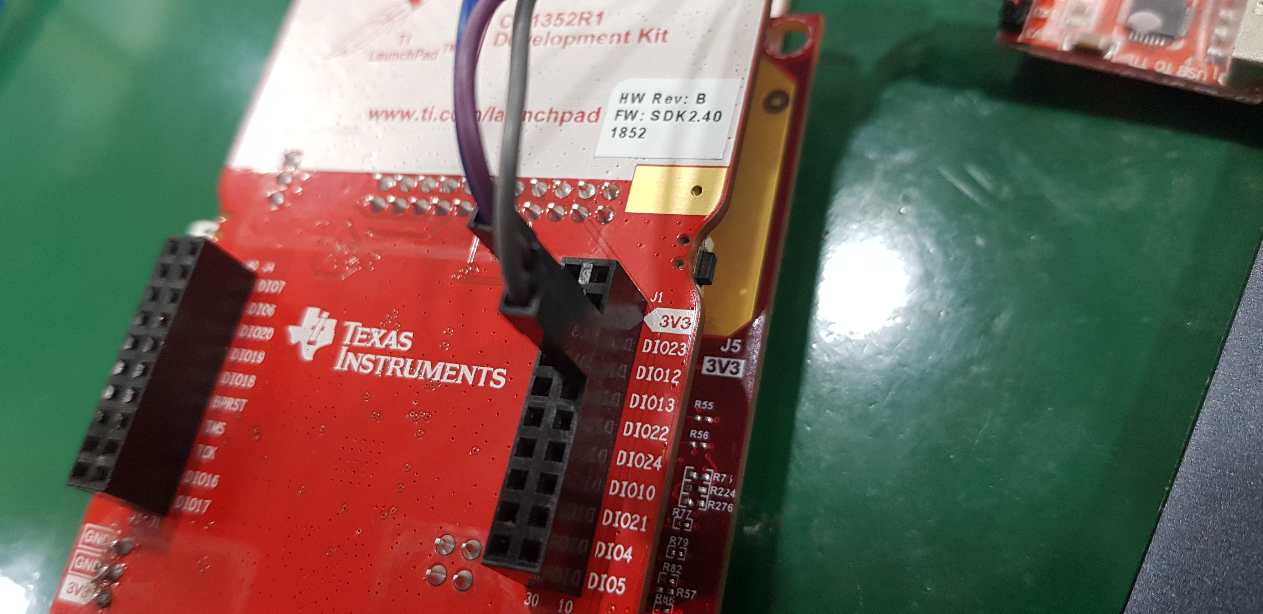

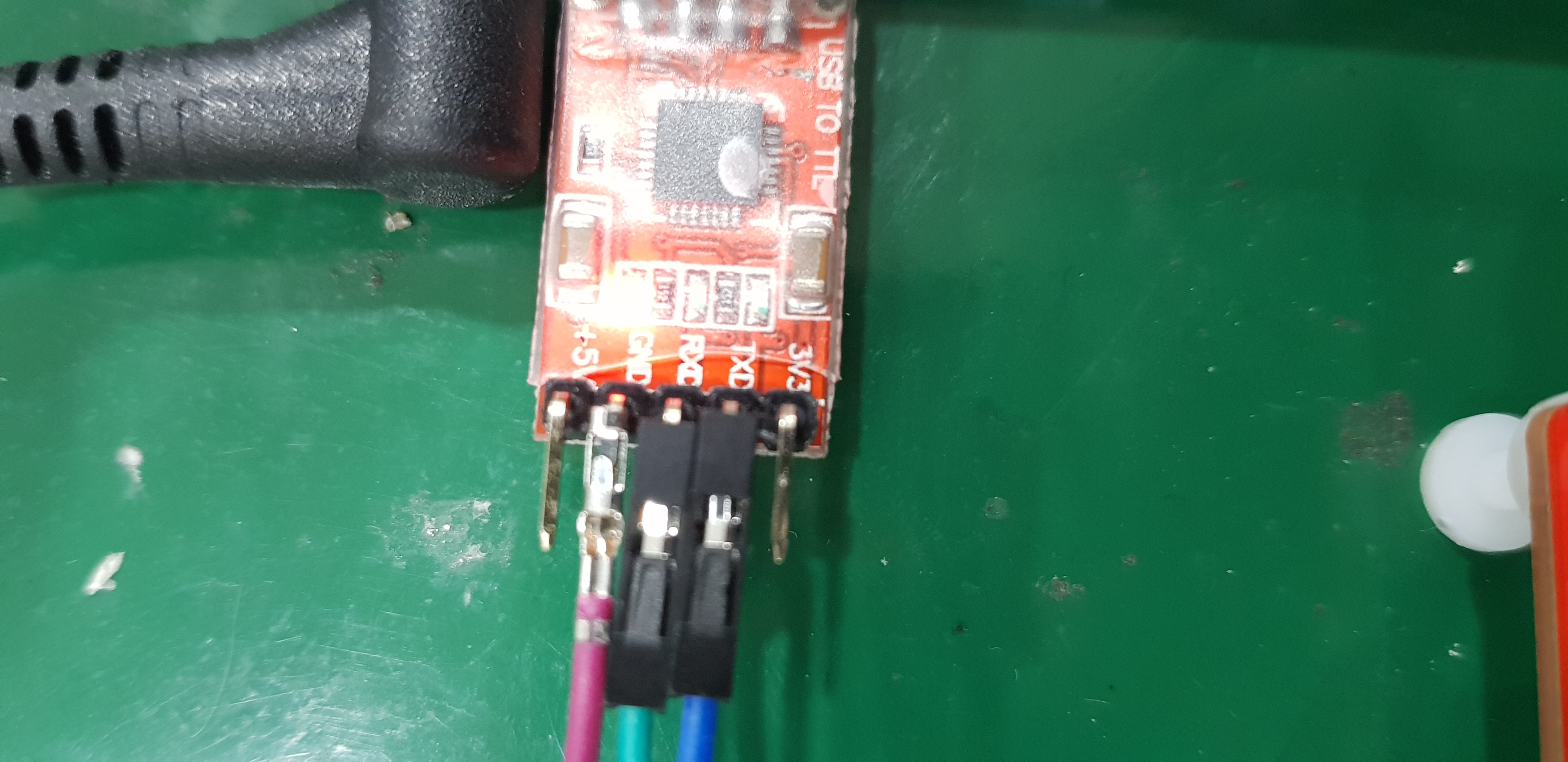

  • "dfeDataOutputMode 1" is not displayed on the screen.
    "you are probing the correct UART pin"
    > connected dio12, dio13, gnd. The uartecho example worked fine.
    "then make sure the sensor is paired to collector"
    > The red led lights up, so it looks like a connection to the connector.
    " and you have waited 30 seconds"
    > There is no reaction even if I wait more than 30 seconds.

  • Yes, Nothing is printed on the terminals.
    And I modified the code manually.
  • Can you flash the pre-built binary that is provided in the TIDA-010022 onto your Launchpad? We have verified that those binaries work, so it will be good to know if this is a software or hardware issue.
    How did you manually modify the code? We are unable to download the zip file that you provide.
  • Sorry Link is wrong:
    wyplug.com/.../sensor_CC1352R1_LAUNCHXL_tirtos_ccs.zip
    >> wapeul.com/.../sensor_CC1352R1_LAUNCHXL_tirtos_ccs.zip

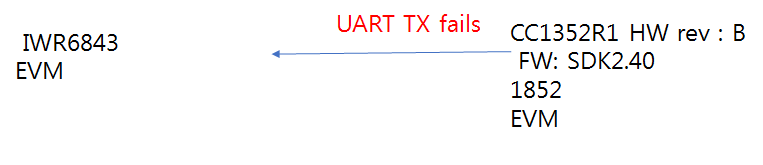

    And the binary is not working with your bin. Your bin file is 2.10 based and our EVM HW is 2.40.x based. Therefore, there is no response or result if we use your 2.10.x based bin file.
    When we applied the patch contents in the source code of 2.40.x SDK source, UART TX fails in the following picture. We don't know what to do further in this project. Please guide us in easy step. not sending out packet when we probe it in UART receiver side in 68

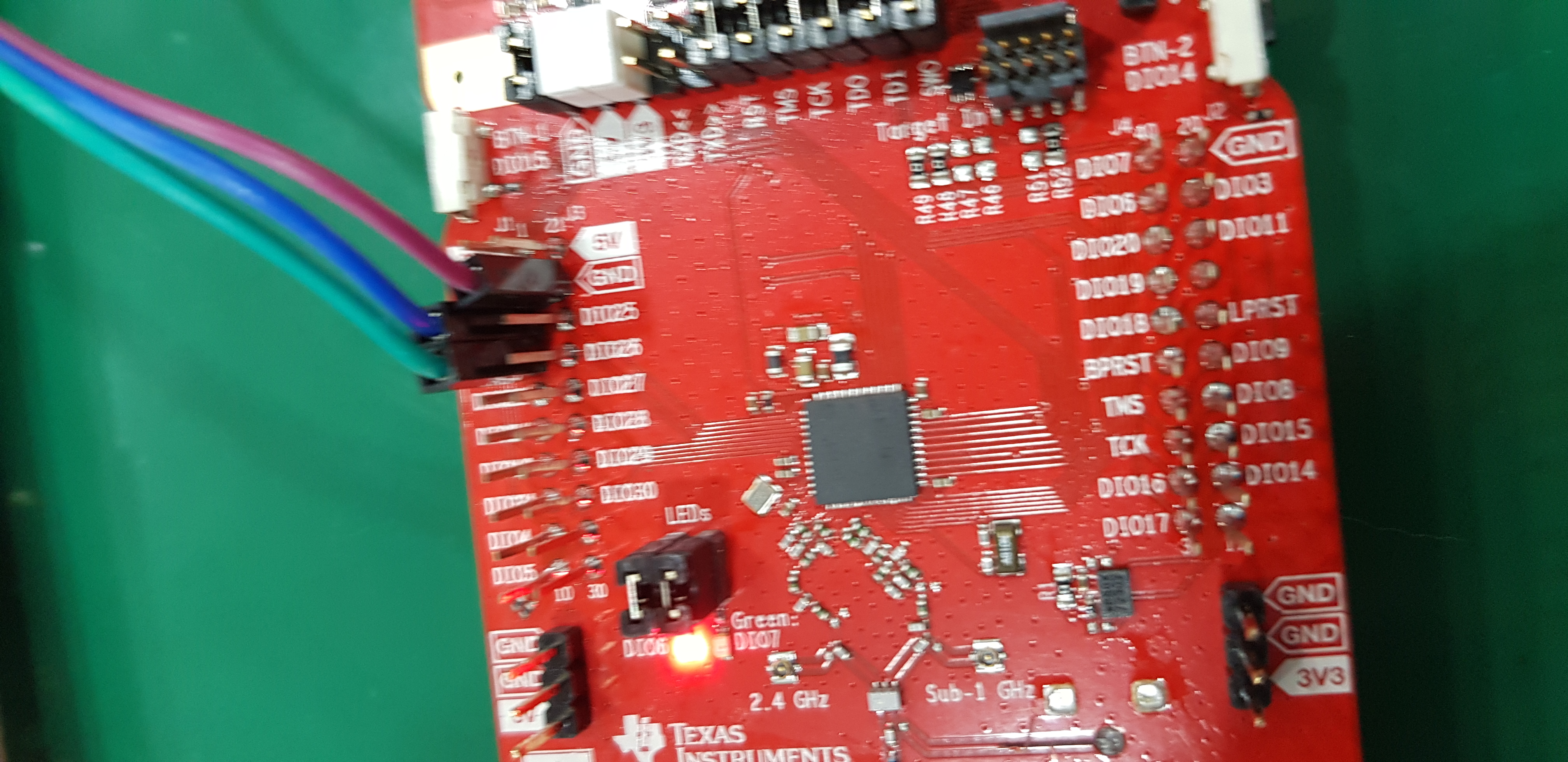

  • Looking at your UART configuration (CC1352R1_LAUNCHXL.c), the UART are configured differently.
    In your code,
    • UART0_BASE points to MMWAVE_UART1_RX
    • UART1_BASE points to CC1352R1_LAUNCHXL_UART1_*.
    In our version,
    • UART0_BASE points to CC1352R1_LAUNCHXL_UART0_*
    • UART1_BASE points to MMWAVE_UART1_RX
    Since the UART pin assignments are different, you will not see the UART output.
    Try the following modifications in CC1352R1_LAUNCHXL.c
    • Line 973-974
    .txPin = CC1352R1_LAUNCHXL_UART0_TX,
    .rxPin = CC1352R1_LAUNCHXL_UART0_RX,
    • Line 989-990
    .txPin = PIN_UNASSIGNED,
    .rxPin = MMWAVE_UART1_RX,
