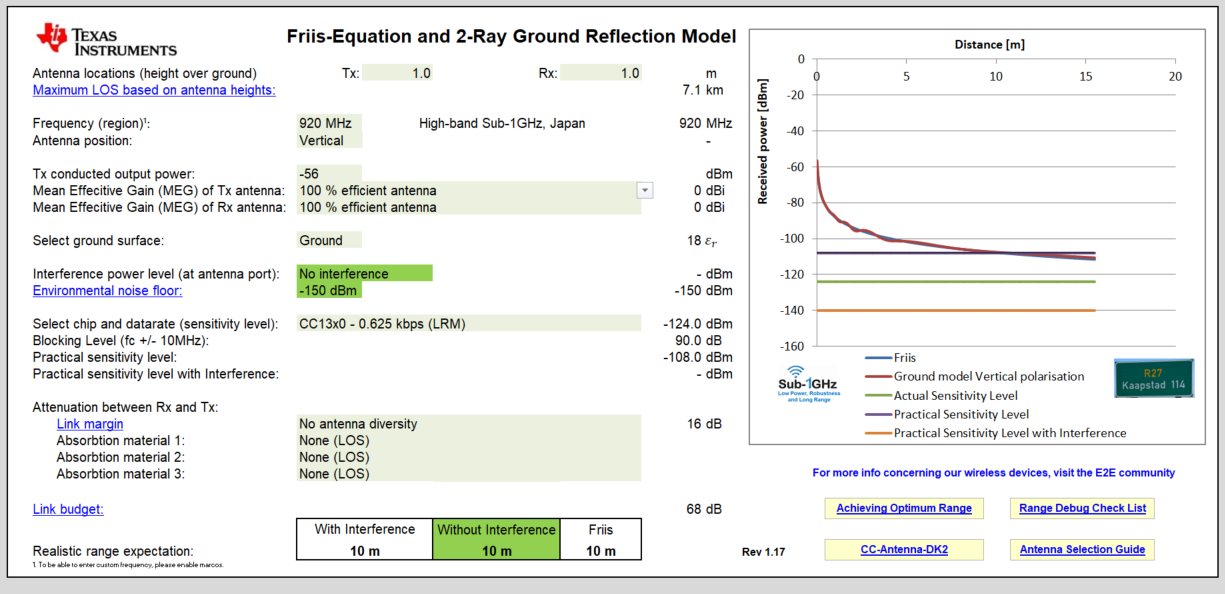

  • Increased the output power with 6 dB to compensate the LB for a LNA on the receiver side; this is roughly 10m distance. Without the LNA, then a rough estimation would be around 5m.
    The accuracy of the range distance is very rough so you should measure this with the kits instead.
    Link to the excel calculator: http://www.ti.com/tool/rf-range-estimator

    Also thank you for the XLS range estimator tool. Very insightful and helpful. I noticed that the setting is -56 dBm...
    Interestingly, if set "Tx conducted output power" to -62 (the japanese are somehow very pedantic about their laws, so I would like to observe 35mV/m at  3m) and change "Link margin" to "With antenna diversity" I get 10m too (without diversity 0m).
    (SWRS181D page 45 shows an example for antenna diversity. The question is would that be a viable solution too.)
