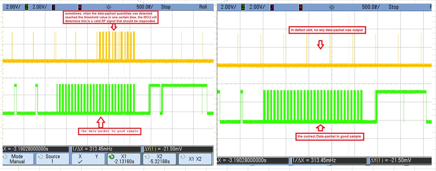

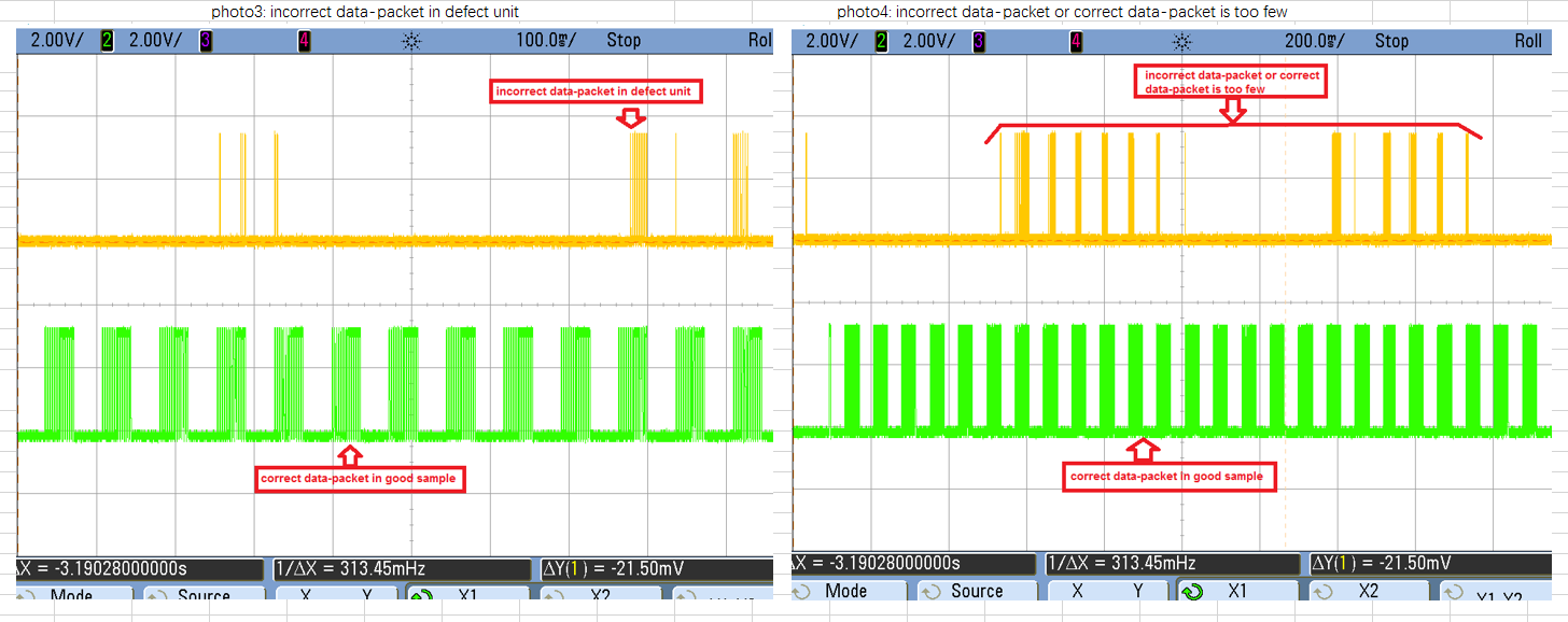

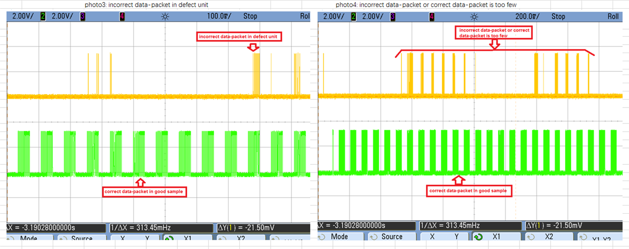

in our recent production (Alarm Clock Receiver), we found many RF chips CC1101 with a serious defect (there is a Receiving Blind area in receiving range less than 5m) , the defect rate is near to 8%, in this Blind area, the receiver almost can't respond our transmitters except for the occasional response.
Alarm clock Receiver description: Carirrer Frequency: 433.92MHz, Modualation: OOK, Baud rate: 333.34bit/s, Frame format: a reference(1/3bit length)+12information bits+back-off (12bits of length).
we test the RF chip GDO0 pin, we found the signal data frame in defect sample is incorrect or incomplete compared with the good samples, details see below photos,

    YK: we did the "PER vs level" test  according to your suggestion (through cable, not over the air), the summary is below,
    1) when RF Level less than -100dBm, RF GDO0 output is abnormal in both of defect unit and good unit,
    2) in range from -100dBm to 20dBm, the GDO0 output is normal in good unit.
    3) in range -100dBm to -95dBm, the GDO0 output is abnormal in defect unit. (YK: in my opinion, maybe this is a tolerance in different RF chip).
    4) in range from -95dBm to -69dBm, the GDO0 output is normal in defect unit.
    5) in range from -69dBm to -50dBm, the GDO0 output change bad in defect unit.
    6) in range from -50dBm to 20dBm, the GDO0 output change good in defect unit.
    Test result: we can see when RF signal is in range -69dBM to -50dBm, there is a obvious "Blind area" in defect unit.
