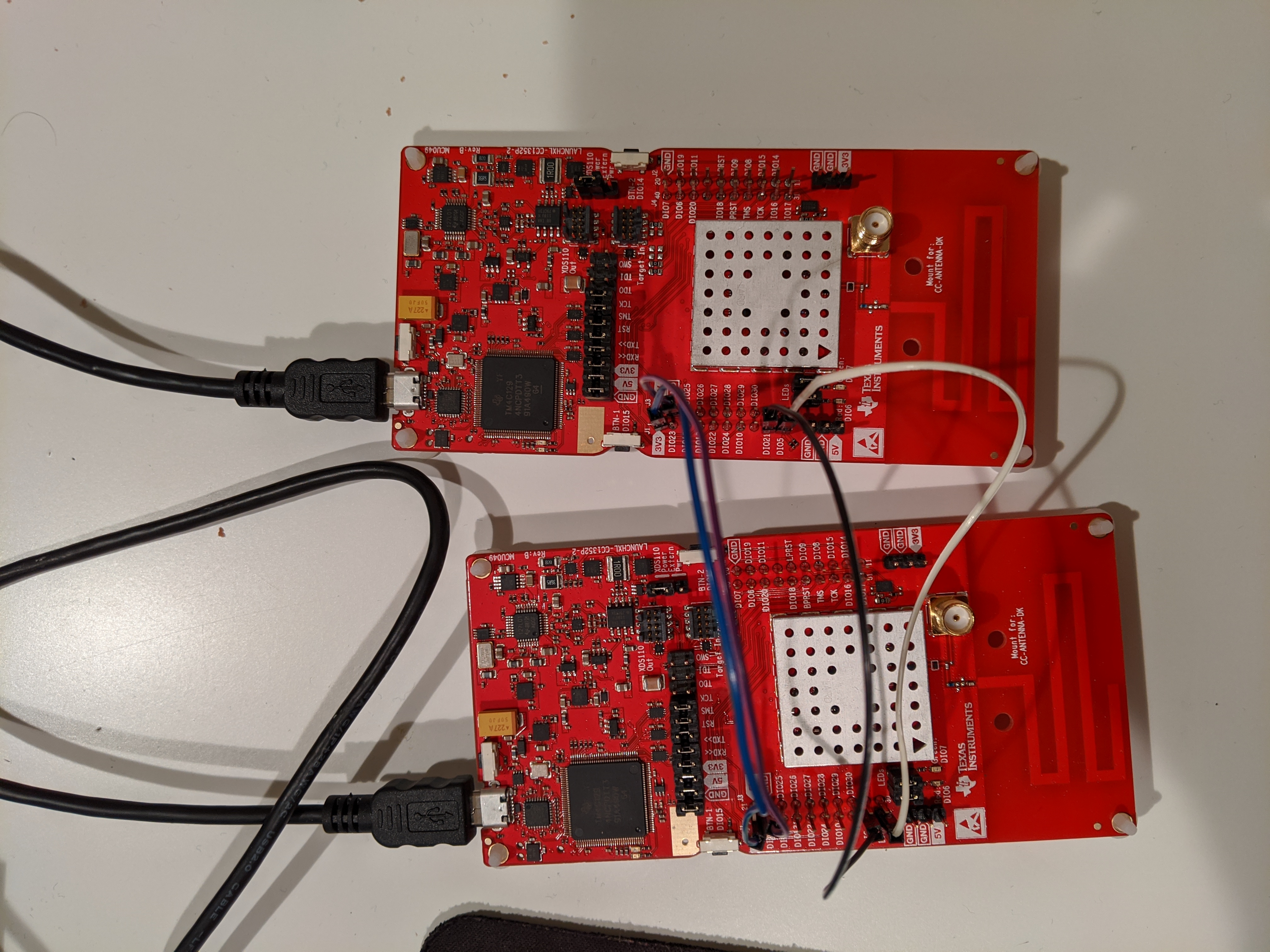

  • Could you take a photo of the setup?
  • Below is a photo of the setup (note that in my *actual* setup I disconnected one of the USB cables below so the power of one of the board actually comes from the other board via the 3v3 pin).
    Please let me know if you need more info.
    Ofir
  • From a hardware perspective it makes sense to use common ground on the two boards but disconnect the 3V3 connection since you are basically shorting the output of two voltage regulators together.

  • Sorry, I was only looking at the picture. When we ask about a picture, my assumption is that the picture shows the actual test setup without any exceptions.
