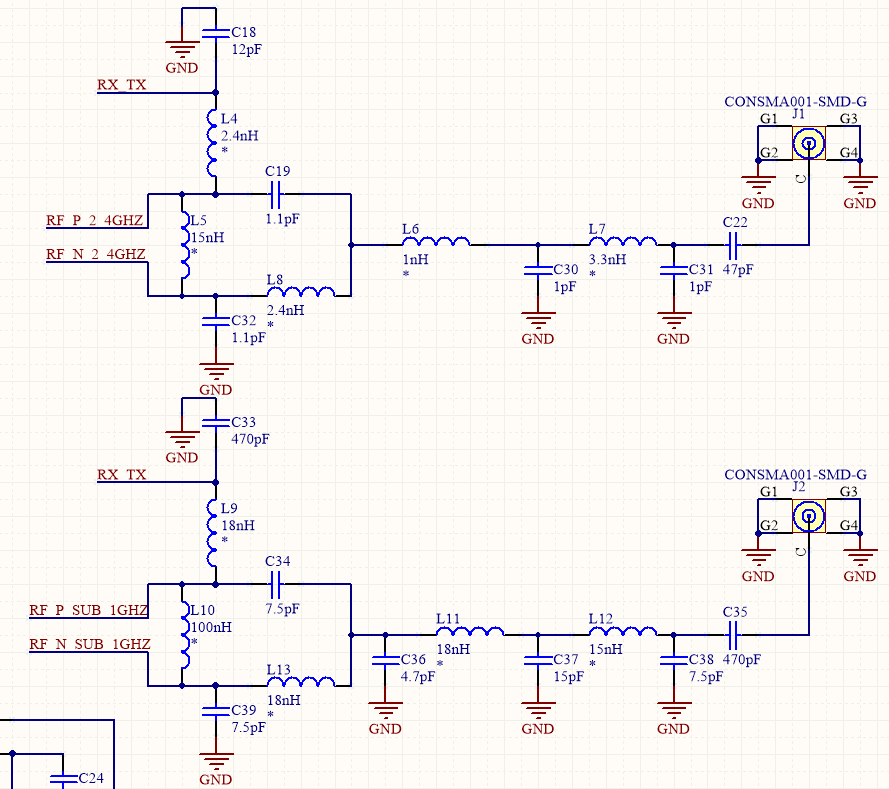

I am looking to utilize the 1352R in an 433MHz and 2.4 GHZ (Bluetooth) application. Documentation seems to be missing ie (swrc352) and some matched-filter baluns are no longer available (Murata). I have already contacted Johanson  to see if they could provide me any help. Unfortunately they couldn't offer me anything that would work for 433MHz . Is there a discrete component reference available or a recommended balun filter? Please help. I could even settle for the 1352P but don't really need the PA.
