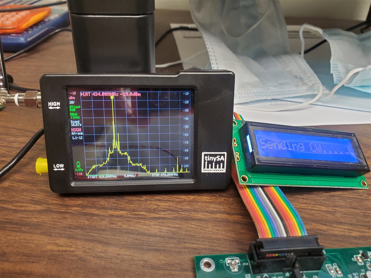

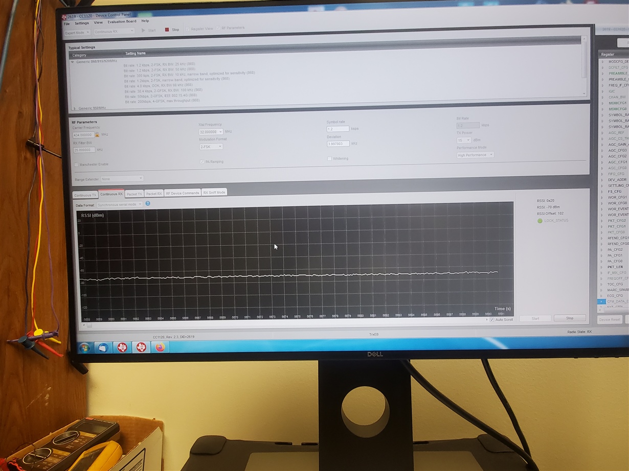

CC1120: Can't get working TX/RX at 434MHZ to work with TRXEB eval board in RX mode
Part Number: CC1120
So, I'm still searching for answers on a few issues with my CC1120.  I have a working custom RX and TX setup (2 similar but different boards) that works in Packet RX mode.  I send a packet from the RX, it is received every time by the RX at about -30db.  My RX registers are slightly different from the SmartRF registers for Packet RX, but not many.  Mostly with a different SYNC and fixed packet length of 10.  My TX registers slightly changed from the SmartRF Packet TX.  It seems to work well in this mode.
My issue started when I put the RX in RF Sniff mode.  It was working, then I discovered that my RX was on 434MHZ and my TX was on 800MHZ (my mistake - I forgot the change the register).  I thought that was strange that it worked like that.  I didn't do that intentionally.  When I changed it so that both were on 434MHZ, RF Sniff didn't work.  I've been trying to figure that out, but haven't yet.
So, I stepped back a little and fired up my TRXEB board.  It has a 434MHZ daughter board.   I set the registers exactly like my RX custom board (except the IOCFG - they work slightly different on my boards).  But, the TRXEB is not receiving any packets from my TX board.  My RX continues to receive every packet.
I have attached my saved TX and RX configs in case anyone spots anything.  Don't know what it could be since those settings work on my boards.
When you "Open CFG" in SmartRF, does it automatically load those settings into the TRXEB?  I don't see any indication of that to confirm that.  Also, I noticed that the Variable Packet Length field doesn't change when Fixed is loaded.
So, eventually, I hope to figure out the RF Sniff problem, but I want to figure out why the eval board doesn't communicate with my TX with my settings.

  • So, I set up my spectrum analyzer to RBX of 10Khz and the TX freq of both the TX demo board and my custom TX board still was 434MHZ on separate experiments.  My spectrum analyzer showed both RSSI at -18dB.  The RX demo also showed the TX demo at -18dB.  But, it showed my custom board at -70dB.  Why would the RX demo board show such a low RSSI, when my analyzer showed it at -18dB?
  • Could you post a screenshot of your measurements with a marker at peek?
  •   [quote user="TER"]
    The first picture is my SA (and custom TX board sending CW), which shows 434MHZ at RSSI -19dB.  The second is the SmartRF showing -70dB.

  • I got the Continuous RX working on my board.  It shows -22dB consistently with my TX sending a CW.  My SA shows -17dB.  The demo TRXEBs show -75dB and -70dB consistently.  Not sure why the big difference.
    With my Continuous RX working, I set the TRXEB board to Continuous TX at 434Mhz.  My RX board registers -85dB, while the other TRXEB shows -23dB.   There is obviously something not right.

  • OK.  A few things worthwhile that I figured out.  I discovered that if I set the demo RX at 20KHZ off freq, the dB is much better (my custom TX at 434.000 and the demo RX at 434.020).  So, a question is we have 0805 parts for the TX, so our techs can make modifications if we have to.  Your demo board has 0402 parts.  Is the tolerance vastly different between the 2 package sizes so that we have this type of freq shift?
