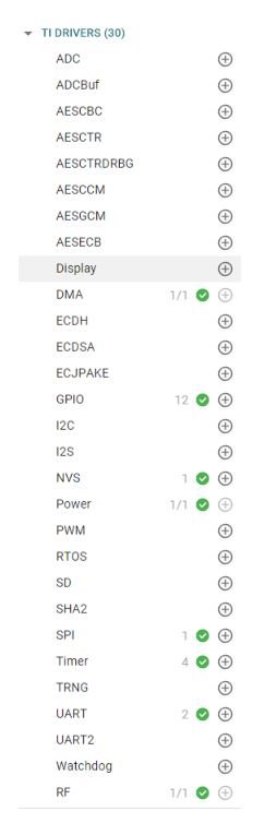

(Peripheral in use in Application-picture below)

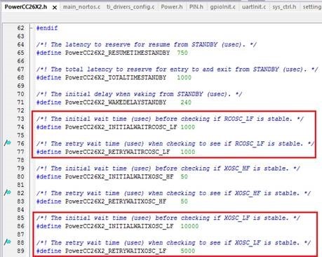

    Q1) What does Initial wait Time & Retry wait Time mean?
           Not used at the application level, is it used at the core level?
          (₩simplelink_cc13x2_26x2_sdk_3_40_00_02₩source₩ti₩drivers₩power₩PowerCC26X2.h)

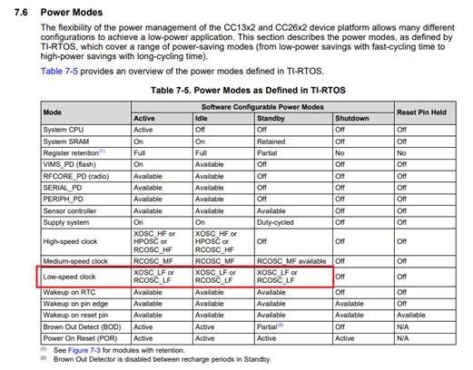

    Q2) Why does FW work normally when XOSC_LF(32.768kHz Crystal) is removed after setting LF(Low Frequency) to XOSC_LF?
          (SWCU185D – ‘Table 7-5’ has a choice between ‘XOSC_LF’ and ‘RCOSC_LF’. If there is no ‘XOSC_LF’ check in the Core as in Q1, will the LF setting be automatically changed to ‘RCOSC_LF’?)
    Q3) It is expected that the LF function (RTC or Power_Sleep) is not used in the current application. What is the range to which the low-spped clock (=LF, ‘XOSC_LF’ / ‘RCOSC_LF’) is applied in the CC2652R1 module?
    SWRS207F – Looking at “6.7 Timer, RTC”, it is said that RTC is used as a timer when TI-RTOS is operated. Does RTC work in NoRTOS?

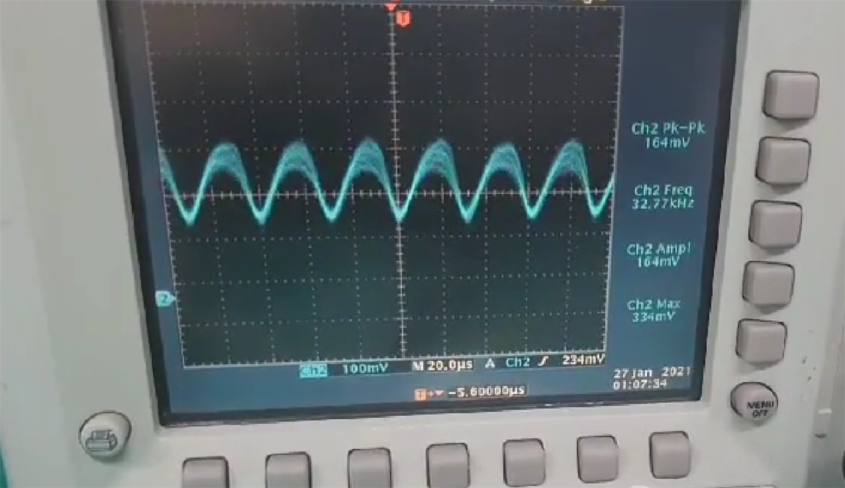

    [ Normal operation ]

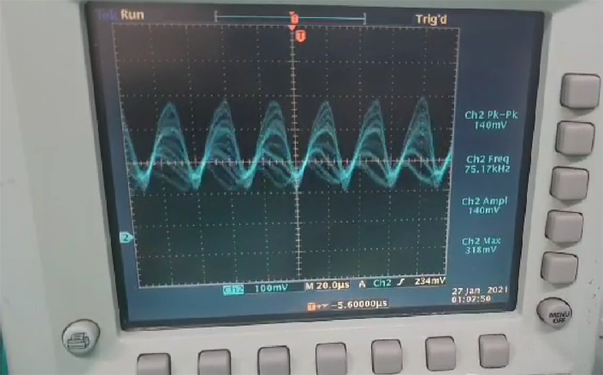

    [ Reset waveform when noise occurs ]

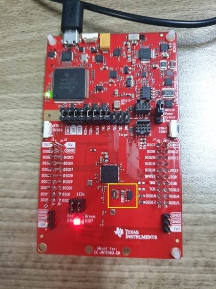

    Q5) FW RESET occurs when the XTAL part of Launchpad-CC2652R1 is touched. Is this the same phenomenon as the Q4 question? (Attachment, uartecho.c)
    When calling SysCtrlResetSourceGet(), 0x05 is returned. Is ‘RSTSRC_VDDS_LOSS -> Brown out detect on VDDS’ correct?
    What is the cause of the brown out phenomenon?

  • Q1: They're used to see how long to wait for the XTAL to stabilize (see the comments in your screenshot).
    Q2: I don't know why it seems to still work, but if you're not connecting the XTAL anyways, I would just set it on the RCOSC_LF mode to be safe.
    Q3: Refer to this thread
    Q4: We don't have a jitter tolerance listed, but the noise you're showing seems problematic. It looks like your crystal is damaged.
    Q5: Crystals are by nature very sensitive to contact. They should not be touched while the device is operating.

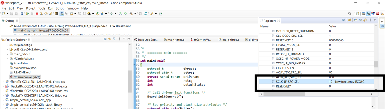

  • Q2) If you want to see which clock is actually being used in operation, check the value of the AUX_DDIO_OSC:CTL0 register with the debugger when active, what is the value of SCLK_LF_SRC_SEL (maybe you can prove a snippet of the whole register)? The XTAL Oscillator will be 11, whereas the RC should be 10. I have it open on my computer now.
    Q3) The external crystal is needed to satisfy RF timing requirements regardless of the RTOS you're using. If your RF communication protocol requires synchronous timing (i.e. acknowledgement of messages sent/received...etc within a window of time) then you'll need the 32kHz XTAL. If the protocol is completely asynchronous, you will not need it. Outside of the RF, the internals on the chip do not use the external clocks at all.
