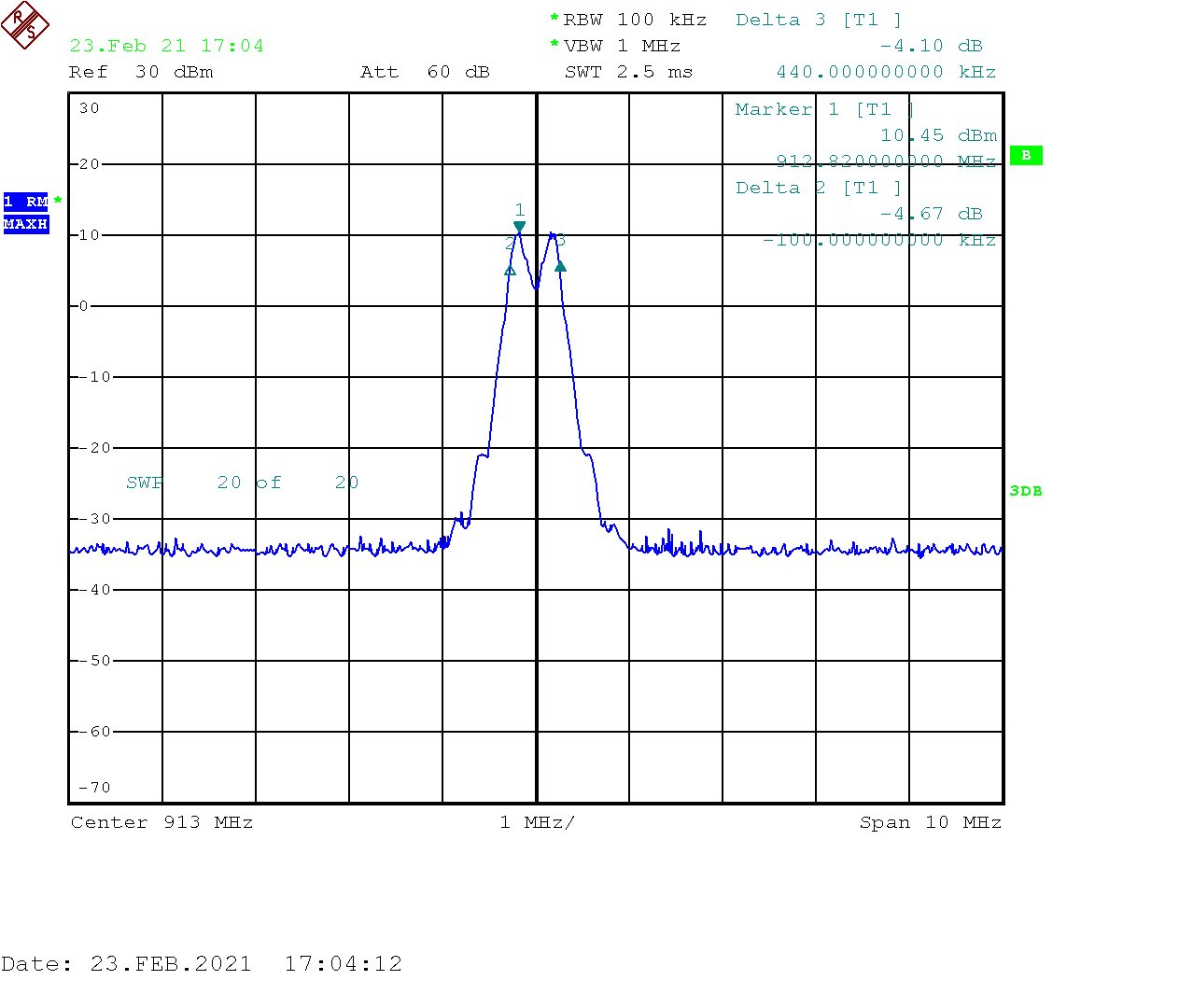

We have moved from LRM to WB modulation to pass FCC, Can you please verify this will meet FCC Occupied Bandwidth requirement and is greater than 500KHz?

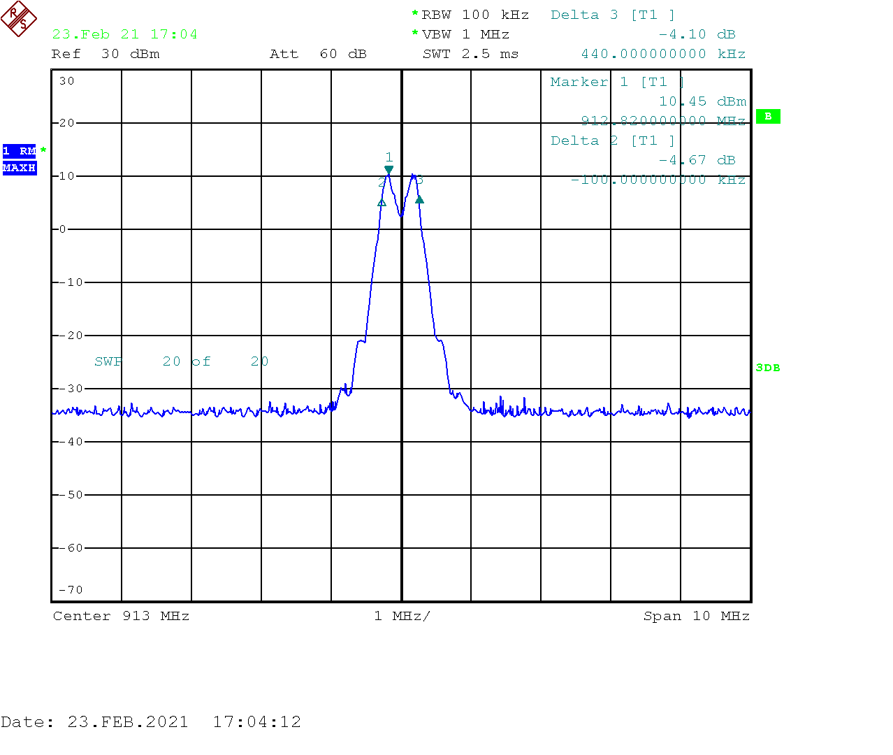

Yes, agree that Marker 3 is at +440 kHz and Marker 2 at - 100 kHz; then the 6 dB bandwidth is 540 kHz.
