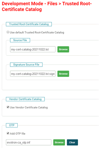

    1. Selection of the certificate catalogue
    1. Including the TI service pack
    1. Adding the certificates
    1. Adding the MCU image
    1. Generation of the OTA file with "Skip Security”

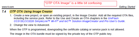

  • Hi Kobi,
    Thank you for your kind support, but I have some more questions.
    1. So far, I have not been able to install the vendor-specific certificates. So far I have done the following:
    I have generated the following certificates and keys:
    - root CA certificate "evotron-root-ca",
    - Code signature "dcc2404-cert-ca", signed with root CA
    - OTA signature "ota-dcc2404-cert-ca", signed with the code signature
    After this I have generated the certificate catalogues and the OTP info file according to the instructions.
    Now I am trying to load the certificate catalogue, the certificates, the OTP and the MCU image in the CC2'3235SF with the UniFlash 6.0.0 and somehow I am not able to get any further. I am right in assuming that the OTP is programmed via UART0 and not via OTA. Is this assumption correct? Section 7.4 on page 13 of the SWRU547A document says the following:
    The last sentence of section 7.4 says that the MCU image must be signed with the root CA key. Does this only apply to this one image with the OTP content? Can all other MCU images without OTP content subsequently be signed with the code signature certificate?

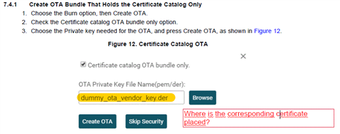

    2. Then another question regarding the encryption of the OTA bundle. Where in the UniFlash tool is it specified which certificate is to be used to encrypt the OTA bundle.
    Kind regards,
    Ulrich
  • Hi Ulrich,
    Only for the catalog update you need the OTP private key (since the catalog is signed by it). For other OTA updates that do not involve the catalog, you can use whatever key you like but the matching public key (the certificate) must resides already in the file system and its filename must be updated accordingly in the MCU code that handles OTA.
    Please refer to:
    • <SDK installation directory>/tools/cc32xx_tools/ota-example-cert for examples of the key. Read the short README file for the required key type
    • look at OtaArchive.c and look for OTA_CERTIFICATE_NAME definition that states the OTA certificate filename
    Shlomi

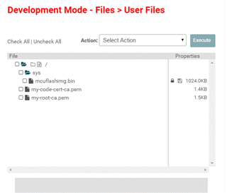

  • Hi Shlomi,
    Thanks for your reply to my second question. But the second question is only a side show.
    I have the problem with the vendor specific code signing certificate. I have found an solved issue in the e2e where Kobi told the custumer that the OTP does not support certificate chains. Please refer here: https://e2e.ti.com/support/wireless-connectivity/wi-fi-group/wifi/f/wi-fi-forum/912445/cc3235sf-vendor-specific-certificate-catalog-and-otp---not-working
    That is why I have generated a vendor specific root CA with key as described above. Then I have generated a vendor specific certificate catalog containing the root CA only and a OTP inf-file as described above.
    After this I use UniFlash 6.0.0 as Kobi told me to test the vendor specific certificate. I have add the generated vendor specific certificate catalog,
    the service pack, the certificate
    and the MCU-Image signed with the private key of my-root-ca.pem. Then I have start the programming using UART0. Uniflash prepares some files, one with a size 94708 of and another with a size of 1008 and than the image programming runs up to 99%. At the end it fails with:
    I don't know what is the reason for that issue.
    Ulrich
    First, using an old Uniflash would only work on Gen2 devices, i.e. CC3220. For Gen3, the older Uniflash does not have the bug so whatever you flashed to the OTP is already flashed and you cannot change it.
    However, I still don't see an issue with the procedure as you included the root CA certificate in the OTP section and also included it in the catalog.
    The error you get usually indicates that authentication of the mcuflashimage fails when tested against the catalog.
    What certificate are you using with mcuflashimage? is it the your root CA?
    Shlomi

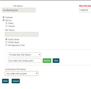

  • Hi Shlomi,
    I have use my root CA to sign the mcuflashimage.
    But I beleave that the OTP is not programmed because I can flash the CC3235SF with the certificates of the playground.
    Ulrich
  • what if you check the "use vendor certificate catalog" and uncheck the "add otp file" and then flash? does it give you an error?
    Shlomi
  • I have checked tihis too and it gives me the same error.

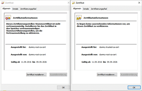

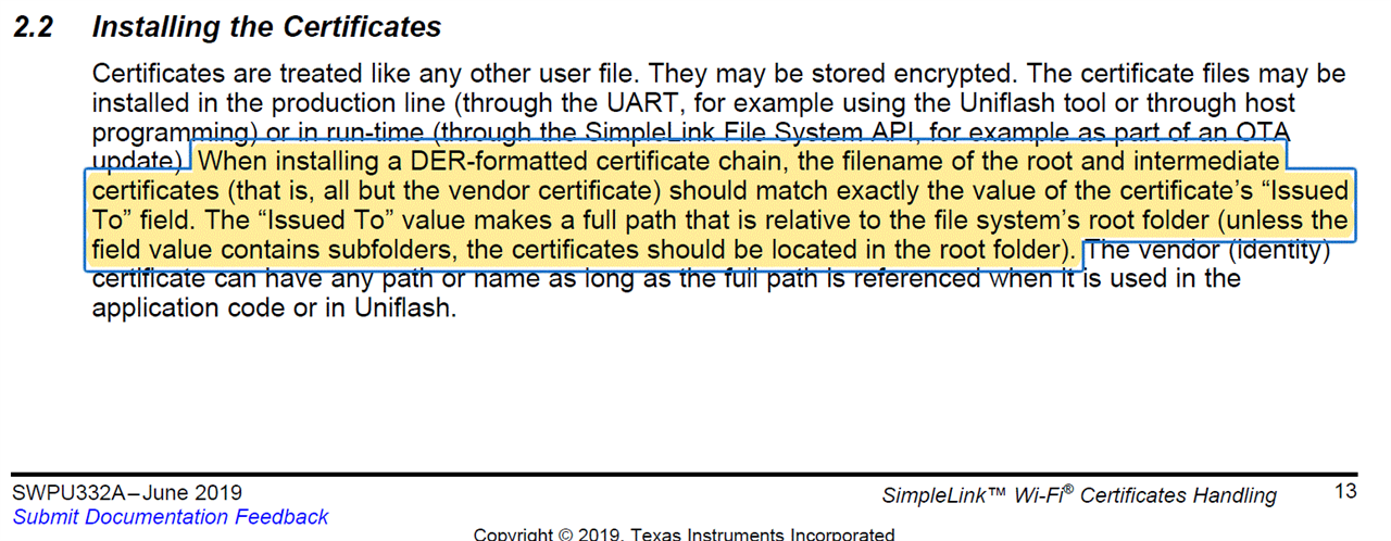

    But I have an idea what's the reason for this behavior. In SWRU455m chapter 8.4.7 is written:
    And then I have analyzed the dummy-root-ca-cert of the playground:
    Thus this mean, that this is a requirement? If yes, then there is my fault.
    Ulrich
    I don't think this is the issue as the certificate does have CN.

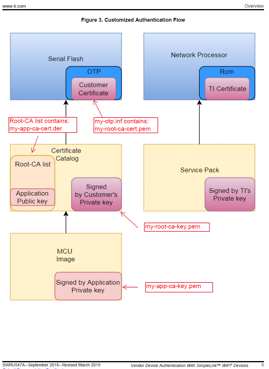

    I have read the documents SWRU547A and SWPU332A again. So am I right in the following:
    I must generate 2 certificates, a vendor root CA “my-root-ca-cert” and a code signing certificate “my-app-ca-cert”.
    The OTP inf-file “my-otp.inf” contains the vendor root CA “my-root-ca-cert.pem”. This certificate is generated with the openSSL command:
    openssl req -x509 -sha256 -days 3650 -newkey rsa:2048 -nodes -keyout C:\Certificates\my-root-ca-key.key -out C:\Certificates\my-root-ca-cert.crt
    The certificate catalog contains the code signature certificate “my-app-ca-cert.der”. The Certificate catalog is signed with the private key of “my-root-ca-cert”. The code signature certificate is generated with the openSSL command:
    openssl req -x509 -sha256 -days 3650 -newkey rsa:2048 -nodes -keyout C:\Certificates\my-app-ca-key.key -out C:\Certificates\my-app-ca-cert.crt
    The private key of “my-app-ca-cert” is used to sign the MCU Image.
    Both certificates “my-root-ca-cert” and “my-app-ca-cert” are placed in PEM-format in the root of the programming image.
    If I understand chapter 2.2 of SWPU332A right, than the CN of the code signing certificate "my-app-ca-cert" must be "my-app-ca-cert".
    So I will try this tomorrow.
    Ulrich
  • Hi Ulrich,
    This is correct.
    As I figured, the programming without mcuflashimg works which proves that it fails because it cannot validate the mcuflashimg certificates chain.
    • The mcuflashimg should be authenticated with the my-app-ca-cert and its matching private key to create the signature.
    • the my-root-ca-cert should reside on the main directory as you showed
    • the my-root-ca-cert must also be part of the catalog (and not the my-app-ca-cert), otherwise you would get this error
    • so the my-root-ca-cert in your case has two usages, one to authenticate the mcuflashimg and the other to authenticate the catalog
    Shlomi
  • Good morning Slomi,
    I have done this as you have recommended, but it doesn't run. Every time the same error message.
    So I have analysed the TI playground certificates "dummy-root-ca-cert" and "dummy-trusted ca-cert" you see the following, "dummy-trusted-ca-cert" is signed by "dummy-root-ca-cert". Both are stored in DER-format in the playground.
    So I have done this too, that meas:
    The certificate "my-root-ca-cert" as above mentioned is stored in the OTP and the certificate catalog is signed with the private key of "my-root-ca-cert"..
    I have generated a root certificate for my app "my-app-root-cert". This is stored in the certificate catalog. And I have generated the code signature for my app "my-app-ca-cert" which is signed by "my-app-root-cert".
    So the OTP contains the public key for encrypting the certificate catalog. The certificate catalog contains "my-app-root-ca", the public key for encrypting the code signing certificate "my-app-ca-cert". The code signing certificate encrypts the mcuflashimg.
    I have tested this without any success. It is frustrating!
    Questions:
    1. Is there something special to know for the generation of the custumer certificate, which is stored in the OTP. I have done this with the following openSSL command:
    openssl req -x509 -sha256 -days 3650 -newkey rsa:2048 -nodes -keyout C:\Certificates\evotron-root-ca-key.key -out C:\Certificates\evotron-root-ca-cert.crt
    The public key of this certificate is shown above.
    2. Are there any other recommendation then the CN of the certificate concerning the generation of the code signature certificate? I have generated the certificate with the following openSSL comand:
    The public key is shown here:

    Shlomi,
    I have a CC3220SF LaunchPad too. So if this feature in the UniFlash 6.0.0 exists. Could you recommend what to do.
    Ulrich
  • Hi Shlomi,
    Maybe the generation of the OTP inf-file makes the problem. I have done this as follows:
    SLImageCreator.exe tools meta --cert "C:\Certificates\evotron-root-ca-cert.pem" --out_file "C:\Certificates\OTP\evotron-root-ca-otp.meta" --mac "000000000000" --usechain
    Option --usechain is the option for signature 2, is this correct?
    The next step:
    SLImageCreator.exe tools sign --file "C:\Certificates\OTP\evotron-root-ca-otp.meta" --priv "C:\Certificates\evotron-root-ca-key.pem" --out_file "C:\Certificates\OTP\evotron-root-ca-otp.meta.sig" --fmt "BINARY_SHA2"
    And at last:
    SLImageCreator.exe tools inf --algo 2 --sign1 "C:\Certificates\OTP\evotron-root-ca-otp.meta.sig" --sign2 "C:\Certificates\OTP\evotron-root-ca-otp.meta.sig" --meta "C:\Certificates\OTP\evotron-root-ca-otp.meta" --out_file "C:\Certificates\OTP\evotron-root-ca-otp.inf"
    I am ask me what's wrong.
    Ulrich
    I am a little confused with all the certificate names. Can you elaborate?
    what eventually goes into the catalog?
    is my_app_root_cert and my_app_root_ca the same?
    What you need is to make sure your chain is linked OK as the example with the dummy_trusted_ca_cert you provided, i.e. the "Issued To" and "Issued By" are linked as expected.
    If I take your my-app-ca-cert.crt which is the higher certificate in the chain, it seems like a self signed certificate which doesn't link to my_app_root_cert. see picture below:
    Since this certificate is not in the catalog, it would fail.
    What I suggest just for the test is to sign the mchflashimg directly with the lower certificate in the chain that you know for sure exists in the catalog.
    Let me know if it works.
    Shlomi
  • Hi Shlomi,
    There were two reasons why my code signing certificate does not work:
    1. I have stored the certificate in PEM format in the image bundle. This causes the error message "FS_ERROR_ROOT_CA_IS_UNKNOWN" , error code -10287. That means the sl_FsClose() could not interpret the content of code signing certificate.
    2. I have filled in the field "email address" when generating the certificate.This causes the error message "FS_WRONG_SIGNATURE", eroor code -10289. The sl_FsClose() interprets the certificate wrong or could not find the certificate in the firmware bundle.
    The OTP certificate still works.
    I have contacted our FAE and he has contacted Roger Monk. Togehter with him I solved the problem.
    Kind regards,
    Ulrich
  • I have filled in the field "email address" when generating the certificate.This causes the error message "FS_WRONG_SIGNATURE", eroor code -10289. The sl_FsClose() interprets the certificate wrong or could not find the certificate in the firmware bundle.
    Curious, was the solution to leave the email address field blank when generating the certificate?  Thanks.
    David R.
  • Hi David, yes you must leave email address blank when generating your certificate or you will have an error.
