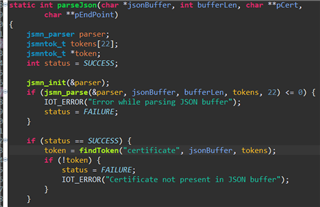

I am now getting errors back from the parseJson() function. I have confirmed that my gateway API is working using postman.
The buffer being passed into the function does appear to be the AWS Certificate used by my "thing". The length is 1192, which is less than the PROV_BUFFER_SIZE of my program.
Initially, I was parsing the JSON message with 5 tokens which was the default, but I had to increase this to 22. Now, it will pass the initial if(jsmn_parse()) line.

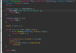

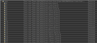

However, I cannot find a way to pass the second test, which is to succeed findToken() . When I dive into this function, the function fails because none of the Tokens are "objects". They are all of the type "Primative".
I've read about primatives, but I don't understand why all of the characters are being read as primatives. They are not NULL or BOOL, so I don't understand why the characters are being interpreted this way. Of course, I just read a little bit about them, so my understanding is far from comprehensive.
Now, I noticed that the tokens are going from Here->There, i.e. 0 to 10, but they all have a size of 0. I would expected 0->10 to have a size of 10. Something is wrong here, and it is preventing me from parsing my 'thing' AWS certificate.

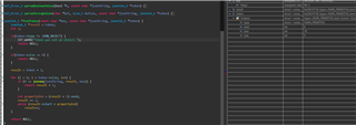

    The issue is that my parser returns null. Initially my parseJson() returned -1 because the findToken() function returned NULL. findToken() checks to see if token->type is OBJECT. Initially, all the token types were PRIMATIVE. I forced the types to be OBJECTS to satisfy it, but then it checks to see if token size is 0. Even if I comment that out, the size determines my iterations in the following loop.  Something fundamentally is flawed with this process, and the struct(s) are not being updated or satisfied in some way.
