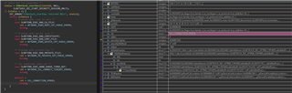

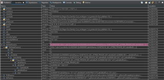

I did a deep dive, and have observed that when tlsDataParams->secAttrib = SlNetSock_secAttribCreate(); is called (line 190 network_sl.c), the object created looks odd. The private key object is very large, length 65,305. I saw that when I was having HTTP issues, and it was because the Private key attribute wasn't created properly.
When I go a few lines down further, the attribute is "set" using
/* Set this device's private key */
status |= SlNetSock_secAttribSet(tlsDataParams->secAttrib,
SLNETSOCK_SEC_ATTRIB_PRIVATE_KEY,
tlsParams->pDevicePrivateKeyLocation,
strlen(tlsParams->pDevicePrivateKeyLocation) + 1);
The object looks okay, when the object is set. The path to the private key is correct and the length is correct. This private key is confirmed good, because the HTTP connections succeed.
