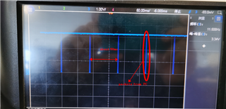

    In addition, I have another question. Our current Bluetooth environment is PC Left right arrow wl1837mod Left right arrow Am3352,
    wl1837mod and am3352 are linked via UART. I observed tx pin of wl1837mod with oscilloscope, I found that the interval between two consecutive packets of data is about 90ms, and the waveform is as follows:
    ★★I want to know whether the 90ms interval between two consecutive packets of data is internally configurable in wl1837mod, or is it caused by the PC sending it to wl1837mod?

    ★★ I'm curious. Is this time interval achieved by modifying the internal configuration of wl1837 through messages when the host and wl1837 establish a connection? There is also a default configuration inside wl1837, which directly controls the time interval of communication data packets.

  • Hi Yunxue,
    I believe this is caused by the PC sending it to the WL1837MOD. If you have another Bluetooth device capable of sending information, you can try measuring the time interval between data transmission again for comparison.
    The time interval is dependent upon the packet type established during connection. It is also dependent on the baud rate.
    It sounds like you are using the Serial Port Profile (SPP) to send a file from the PC to the WL1837MOD via Bluetooth. Improving the SPP data rate is not straightforward as it depends on multiple factors including MTU size, negotiated packet over-the-air packet type, and UART buffer size. You can find some more information here
