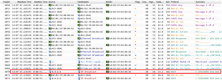

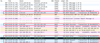

The tcpdump of wlan0 shows that the first DHCP Request is sent through the wlan0 interface:
 see tcpdump-wlan0.png (attached logs)
The wireless packet capture or the AP logs never shows the first DHCP Request, but only the following full DHCP process from DHCP Discovery.
  see wireless-packet-capture.png (attached logs)

Jan 19 03:07:32.334156 imx6sleg-mcg systemd-networkd[370]: DHCP CLIENT (0x8de2fb6): REQUEST (init-reboot)
Jan 19 03:07:35.106940 imx6sleg-mcg systemd-networkd[370]: DHCP CLIENT (0xcd9d2529): REBOOTED
Jan 19 03:07:35.127263 imx6sleg-mcg systemd-networkd[370]: DHCP CLIENT (0xcd9d2529): DISCOVER
