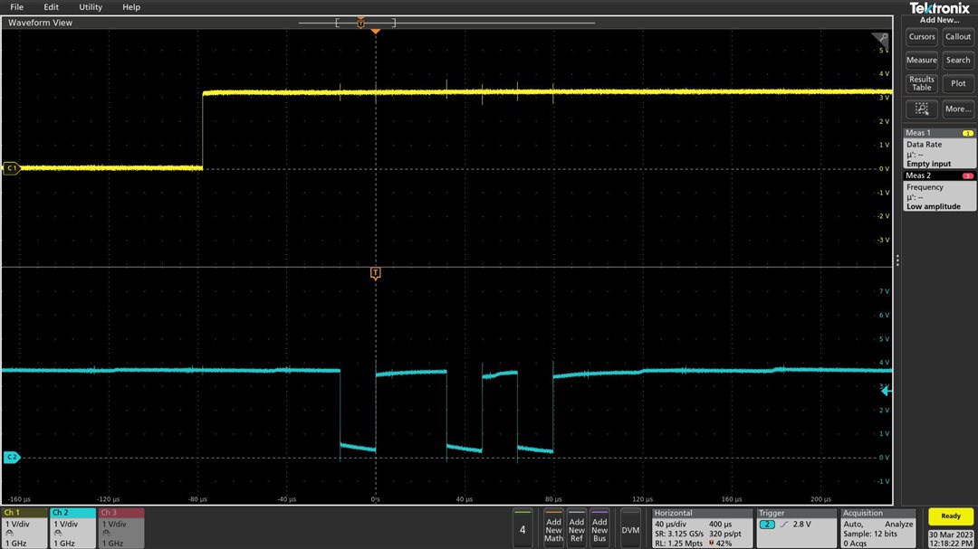

I'm working on SPI data transfer between MSP430FR5969 (configured as SPI Master) and LaunchXL-CC3235 (configured as SPI Slave) and facing some issues. The implementation and problem statement are as follows. Can someone please help?
Implementation:
  • MSP430FR5969:
    • configured as master
    • SPI configuration involves clock at 1 MHz, mode 0 and eUSCI_B0 for SPI interface
    • Pin 4.3 (GPIO) configured for interrupt low to high => this responds to Slave ready signal from CC3235 and carries out SPI Transmit in ISR.
  • LaunchXL-CC3235:
    • configured as SPI Slave
    • SPI parameters are as specified in the program attached herewith.
  • for this implementation, I followed below-mentioned steps:
    • firstly I implemented CC3235 - CC3235 master-slave program. The one provided with the simplelink library file. The implementation worked just fine. In the same code, I carried out many modifications and with that as well, the code ran properly. Modifications I did are as follows:
      • replaced all threads with FreeRTOS tasks.
      • removed master ready synchronisation lines.
      • changed Slave Transmit message length, message text and number of time the message is being transmitted.
    • Noe, since all went well, I implemented MSP430 master SPI transfer program. This also worked fine as I could see data available on oscilloscope from MOSI pin of MSP430FR5969.
Problem:
  • CC3235 generates a slave ready signal on one of its GPIO. This is visible on oscilloscope.
  • This slave ready signal is provided to Pin 4.3 of MSP430. Based on this signal, an interrupt gets generated and MSP430 transmits data over its MOSI pin. This is also visible on oscilloscope.
  • The problem is, when CC3235 executes the command SPI_Transfer(), it then reaches to the section dmaErrorFxn. What logically should happen is, SPI_Transfer() shall either return True or False. Bus this somehow does not happen.
Can you please look at the implementation and let me know?
Please let me know if anything else is required on this from my side.
