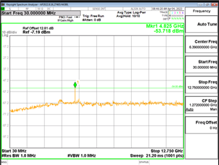

WL1837MOD: 2.4GHz Rx spurious emissions failure at 2nd harmonic
Part Number: WL1837MOD
I see several other posts about this issue but none have a resolution that is working for us.
We are seeing an emission in receive mode around the 2nd harmonic for 2.4GHz WLAN at 4.825GHz that is over the -54 dBm limit.
We were using fw file wl18xx-fw-4.bin and INI file WL1837MOD_INI_FCC_CE_JP. We tried changing NumberOfAssembledAnt5 from "01" to "02" based on other posts I saw here. This brought the measurement from -52.798 dBm to -53.718, still failing.  The original ini file is below.  Please let us know what else can be tried, or any other information needed to assess. Any help would be appreciated.

    Yes, spurious emissions in receive mode. The limit is -54dBm for Korea. In case it helps at all, there are several other tickets for the same issue under "Similar topics" on the right of this page, however they don't have resolutions.

    Thanks for the info! Yes, I've been reviewing some of the older posts on this issue (some of which led to the FW update). I've looked over your design and nothing stands out, which I sort of expected since your are marginally failing. Would it be possible to get a capture of the conducted RSE testing? Your design matches our EVM design so I would like to compare with some of my testing (I don't have capabilities for radiated testing during this time).
    Lastly, could you try the steps below as well? I confirmed with Seong and these helped solve a previous customer issue with similar results.
    1. After connecting the EUT to RTTT and loading the FW, open LuaShell by clicking View -> LuaShell.
    2. Enter the following commands in the LuaShell window before starting the RX Spurious Emissions test:
      • ts18.API_SetAntennaMode_24G (1, 1, 0, 0, 1, 1)
      • ts18.API_ChannelTune (0, X, 3)
        • Replace X with the Channel number to test; 1, 7, or 13.
    3. Click on the RX tab on RTTT
    4. Click on "Statistics Mode" to put the device in RX mode.

    We will try the steps you suggested and let you know how it goes. Below is a capture of the failing result of our testing- let me know if you were looking for something else. The test is conducted.

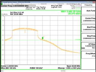

    We also have an issue with one of the band edge scans for 2.4GHz. The limit is -30dBm but it measures almost 2dBm higher at -28.270. This occurs while using the global INI applied limits. We are able to pass by using sliding the power setting down to 16 in RTTT, lowering the average output down from 26.3 mW (14.2dBm) to 23.28 mW (13.67 dBm). We'd really prefer not to have to make this change and just use the original fw and global INI file as is. Can you help support this issue here as well or should I set up another thread?

  • Hey Sarah,
    No need to make another thread if we are talking about the same hardware design.
    Unfortunately, I do think the best way to fix the issue pertaining to the band edge scan would be to manually limit the power.

    The LuaShell commands fixed the issue, thank you!   I have two remaining questions..
    1. For the spurious emission issue in Rx mode, we changed the NumberOfAssembledAnt5 from "01" to "02." Other tests were performed without this setting changed and passed.  Will changing this in our INI file affect any other settings or performance?
    2.  For the band edge issue, adjusting the slider in RTTT down to 16 lowered the power enough to pass. I'm trying to update our INI file with this change and I don't have access to RF measurement equipment anymore to verify it so I am hoping you can give some guidance.
    I understand the PwrLimitReference11ABG is set to 0x64 or 10 dBm, and the PerChanPwrLimitArr11ABG bits per channel are added on top of that for the final output power, so to achieve an overall output power of 16, I have set that nibble to 6. My updated INI is attached.. If I load this file into RTTT will the SW reflect the new value for each channel? The value seems to remain at 30dB for all channels. Is there a way to view the INI settings in RTTT?  If not would you mind reviewing my updated INI file and letting me know if it looks like the right thing was changed?

  • Hey Sarah,
    Let me get double clarification on item 1 with one of my SW experts.
    For item 2, I should be able to run some tests on my EVM in the lab to confirm if those settings are being implemented correctly. I can get you this feedback by early next week if that works for you.
  • That would be great, thanks! Just for your reference- our lab saw that moving the slider down to 16 changed the average output power from 26.3 mW (14.2dBm) to 23.28 mW (13.67 dBm) and got the band edge below the -30dBm limit.
  • Hey Sarah,
    Thanks for the info! I’ll provide a progress update Monday.
  • Hi Dylan,
    Any update?
  • Hi Sarah,
    My apologies, I totally forgot I had training at the start of this week. I was able to run tests in the lab today to confirm that the setting you are adjusting is indeed limiting the power as expected (following the description in section 6 of this app note).
    Going back to your first question, there is no expectation that adjusting the NumberOfAssembledAnt5 parameter will impact any other setting or performance.
  • Dylan,
    Great! I really appreciate you running that test since we are unable to check this ourselves. I have no more questions or issues here, thank you so much for your help!
    Take care,
    Sarah
