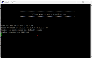

actually no one asked me to generate that file, I have Problem in NWP so for that reason I was develop that file, so right now I want to Send that file to TI Engineer so they can tell me what's the problem. How I can Do that?
Actually, my board is no connecting with AP. It Will Stuck after going In Station Mode & when I put the board in AP mode it will shows Signal on mobile but very week Signal and on Laptop it not even Shows Signal.
In Above program (fig) it gets stuck in Station Mode
When I put the board in Finding AP Mode it will Not be able to retrieve the network List.
This looks like hardware design issue (problem with RF design). I think capturing NWP log will not solve anything.
Do you use CC3200MOD or CC3200 QFN?
Did you asked TI for review of your design, if not ask here. Did you validated your RF design by measurement (e.g. testing your antenna matching at VNA, checking output power at spectrum analyser and tuning center frequency in case of QFN is used)?

I am Using CC3200 QFN. I didn't ask for design review yet. I will take Design review & validate RF design Then we Will Discuss till I am closing that thread.
