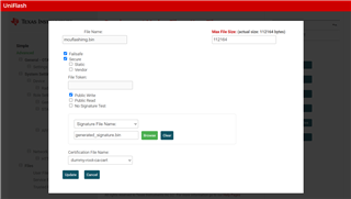

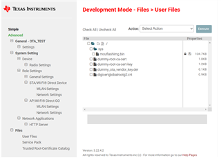

4. my uniflash setup attach below

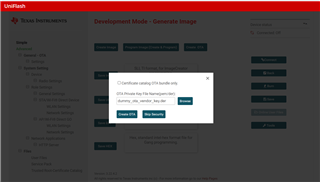

5. My .tar file is attached. Please review if anything is missing.
5482.20240310081436_CC3220SF_OTA.tar

    Can you assist in creating the ota.tar file and identify which certificates are used as OTA_SERVER_ROOT_CA_CERT?
  • regarding the first question - the answer is yes: use OTA_FILE_DOWNLOAD and set the URL with OTA_set(EXTLIB_OTA_SET_OPT_FILE_SERVER_URL...).
    For the OTA_SERVER_ROOT_CA_CERT - if Azure doesn't provide the info - you can use the same method (i.e. set any root CA and look for the error code with the requested certificate).
    We tried the OTA_FILE_DOWNLOAD method by commenting the OTA_SERVER_ROOT_CA_CERT section. Then, using CloudOTA on CCS debug mode, it was successful. The logs are attached below.

    _SaveOtaVersionFile: save version file also in the bundle, version=
    OTA_run: ---- Download file completed OtaRunStep: status from Ota_run: Download done, status = 104
    OtaImageTestingAndReset: download done
    OtaImageTestingAndReset: call sl_Stop to move the bundle totesting state
    OtaImageTestingAndReset: reset the platform to test the newimage...
    The same CloudOTA bin file flashing through UniFlash is encountering some signature parsing errors. Detailed logs are attached below.

    Uniflash setup:

    When building a secure OTA image you need to sign it with a private key.
    In our example it works with "tools\cc32xx_tools\ota-example-cert\dummy_ota_vendor_key.[der/pem]".
    In such case you will need to have "dummy_ota_vendor_cert.der" in the file-system (for verification).
    If you use your own certificate pair and the certificate is written inot other path or name - you should replace "OTA_CERTIFICATE_NAME" (in OtaArchive.c) and rebuild the ota library.
