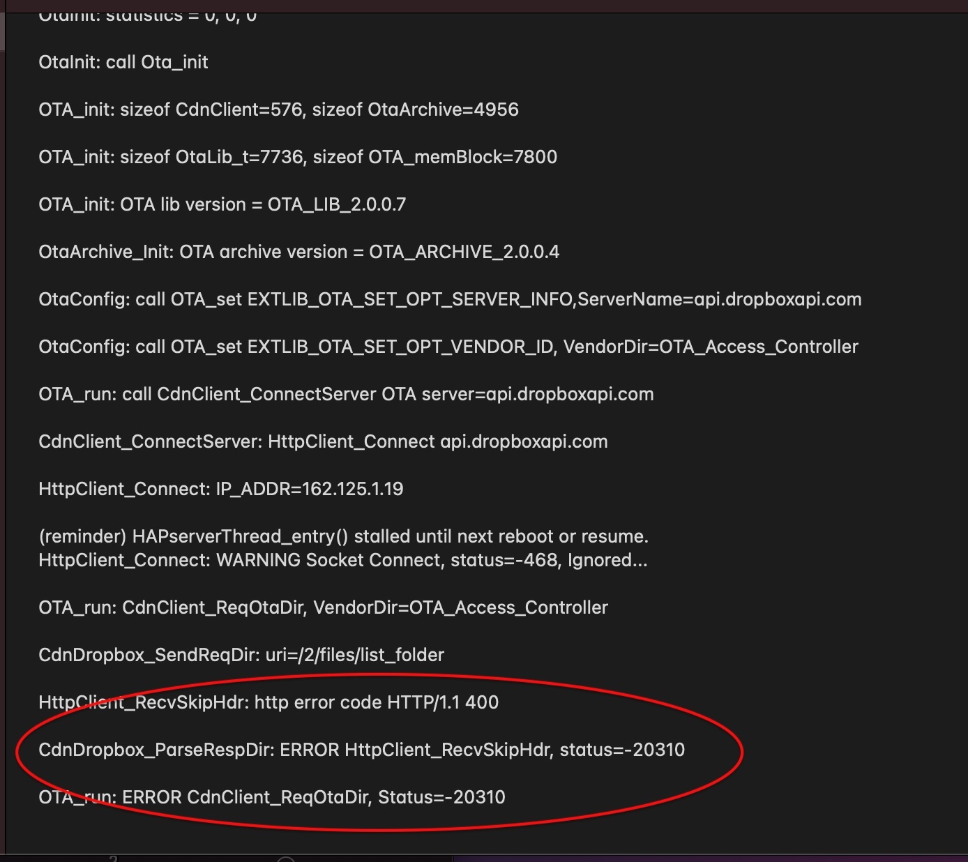

  • Hi Kobi,
    That syntax change you recommended did allow me to get a clean build. I re-ran the OTA experiment (using the new style longer Dropbox access token and the longer definition for MAX_VENDOR_TOKEN_SIZE), I enable OTA tracing, and the following transcript shows where it hangs:

  • Hi Steve,
    in CdnDropboxV2_SendReqDir() (within CdnDropboxV2.c) you will need to increase the size of ReqDirCmdBuf.
    250B (instead of 200) should be enough to prevent the HW exception you are getting.
    However once i've done this, i'm facing some authorization issue (HTTP error 401), so i need to read the documentation once again (i may missed something in the creation of the new Dropbox app or need to update the request).

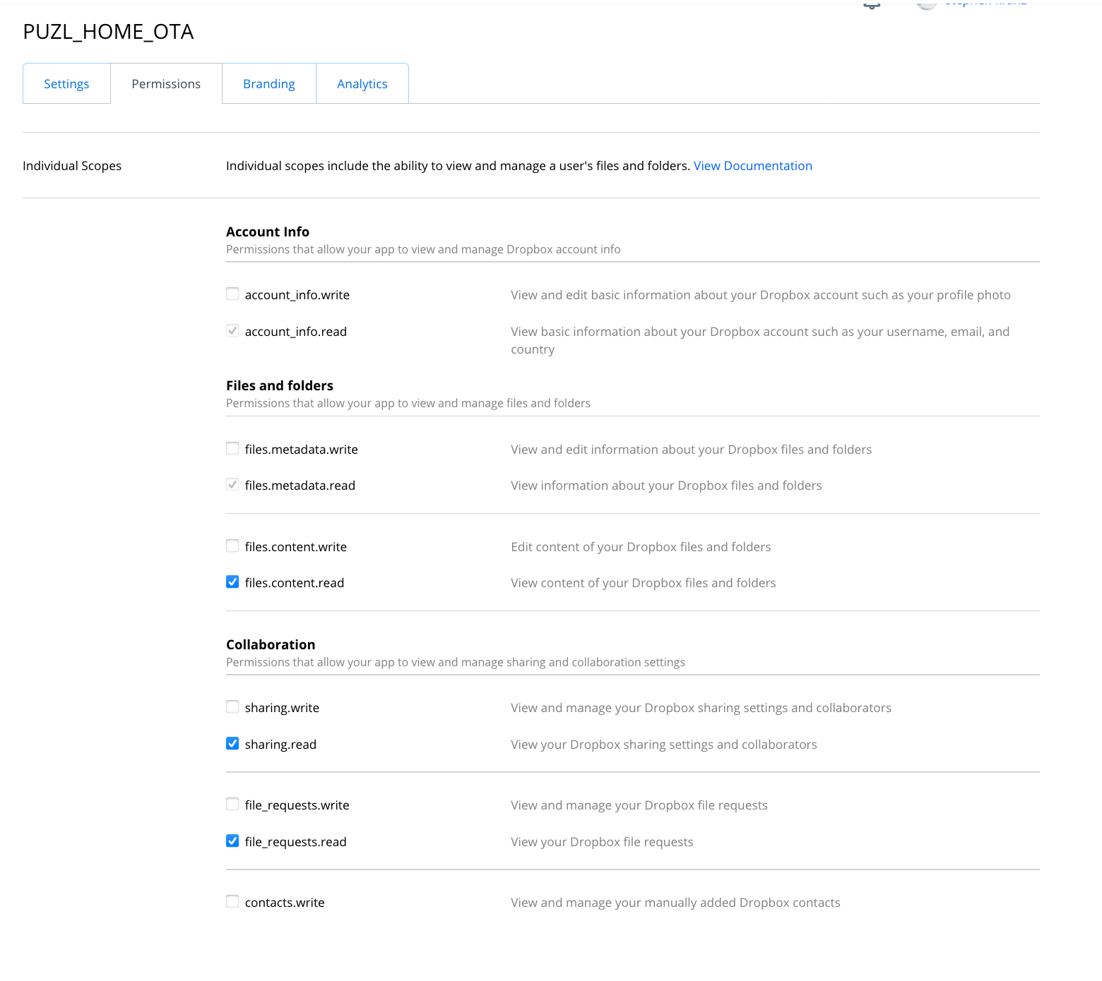

  • Hi Steve,
    It seems that if you set the "Access token expiration" as "No Expiration" and then generate the token - it will be short (as before) and new app will work.
    Make sure the right permissions are set also (i.e. at least the "files.metadata.read" and "files.content.read").
    Br,
    Kobi

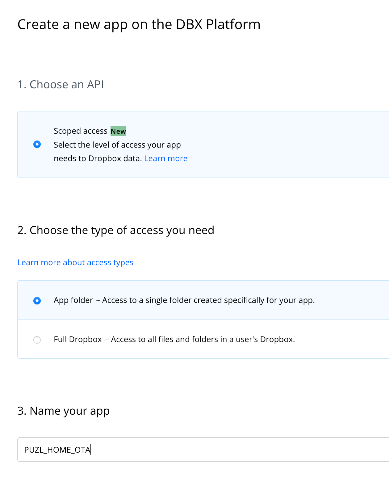

  • Hi Kobi,
    I tried the experiment today using the new shorter DropBox Access Token and paid attention to setup the Dropbox permissions for readibility as you suggested. For my experiment I reverted the earlier experiments you had suggested and put the TI OTA feature back to it’s original form. In other words:
    #define MAX_VENDOR_TOKEN_SIZE   150
    …was put back to…
    #define MAX_VENDOR_TOKEN_SIZE   96
    And the two instances of:
    uint8_t ReqDirCmdBuf[250];
    …were put back to…
    uint8_t ReqDirCmdBuf[200];
    At this point I was back to the same cc32xx_sdk_4_10_00_07 source that I had been using successfully with the old style DropBox Access Tokens except of course I made the necessary two lines of edit to the following otauser.h definitions to accomodate the new 65 byte DropBox Access Token I had just acquired for the experiment.
    #define OTA_VENDOR_DIR  …
    #define OTA_VENDOR_TOKEN …
    I was unable to get a successul connection to DropBox. The transcript shown below shows the particular http error encountered. Again, putting the two lines of otauser.h back to that of the old style DropBox access token puts me back to a working OTA feature. If there was some additional logic change required to migrate to the new DropBox Access Tokens I’d be happy to try it.  See below for error:
    Steve K.
  • Hi Steve,
    Please check your settings. Make sure the token and folder name in "otauser.h" matches exactly the Dropbox settings.
    I've verified this with the original OTA library.
    The only exception is that I enabled all the permissions in Dropbox (read and write) although i believe only the read access is relevant.
    Br,
    Kobi

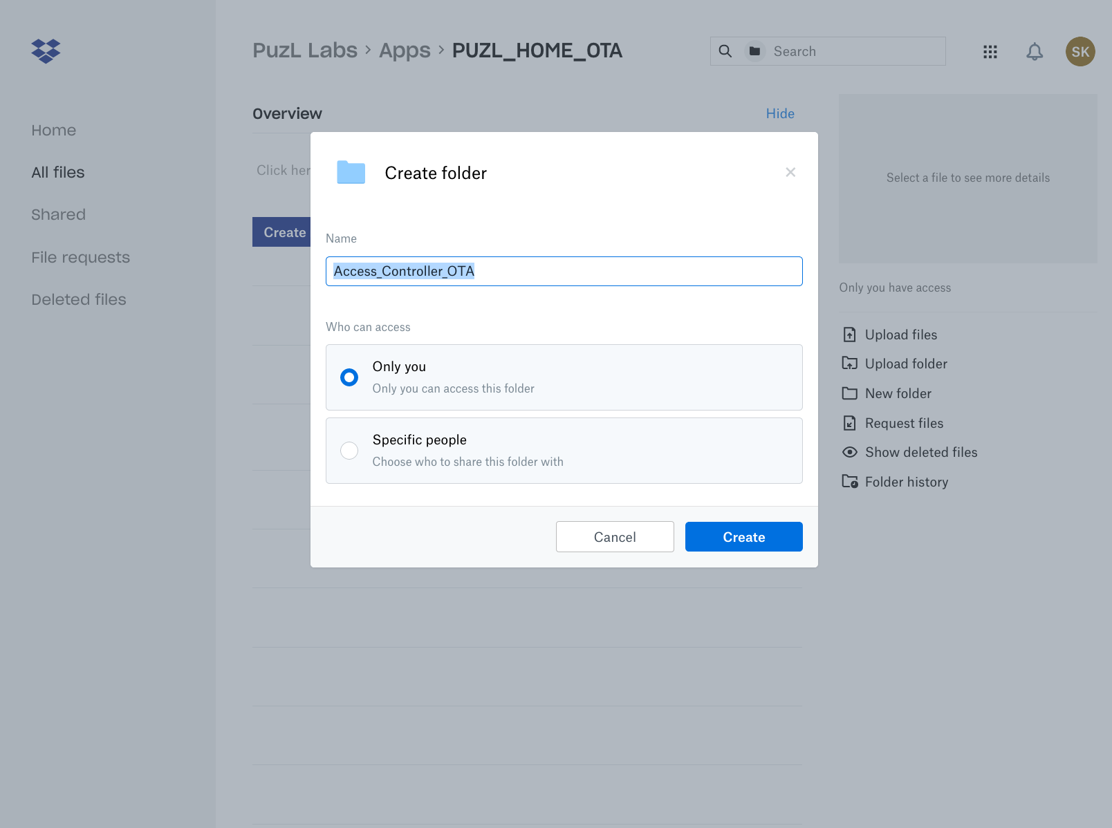

  • ... Correction with what I typed in last post ...
    #define OTA_VENDOR_DIR  "ACCESS_CONTROLLER_OTA"
  • Yes, I created a new folder (new name) under the new application and updated both OTA_VENDOR_DIR and OTA_VENDOR_TOKEN accordnigly.
    Br,
