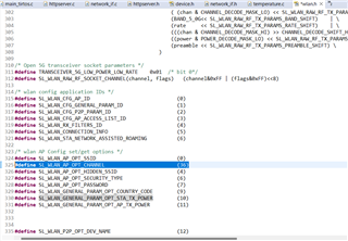

  • Hello; I am running my device in Acces point mode but it works as 2.4Ghz. How can I run it as 5Ghz.
    You need to set proper channel by API SL_WLAN_AP_OPT_CHANNEL. Personally I never tested this, but according SWRU455 this should work.
    Jan
  • i just changed it here i made the channel 36 but it still shows as channel 1 and it works 2.4 gHz.
    No. You cannot modify host driver by that way. You need to call proper sl_ API to set option. For mode details see SWRU455.
    Do not modify host driver files. If you do that, that you have chance that you broke something.

    You should add API call SL_WLAN_AP_OPT_CHANNEL after changing device (sl_WlanSetMode()) mode and before NWP reset (sl_Stop()/sl_Start()).

    this is how I change it, right?
    Yes, this looks correct.
    Please see SWRU455 at appendix B1 where is stated which sl_ APIs need to NWP reset to be applied.
