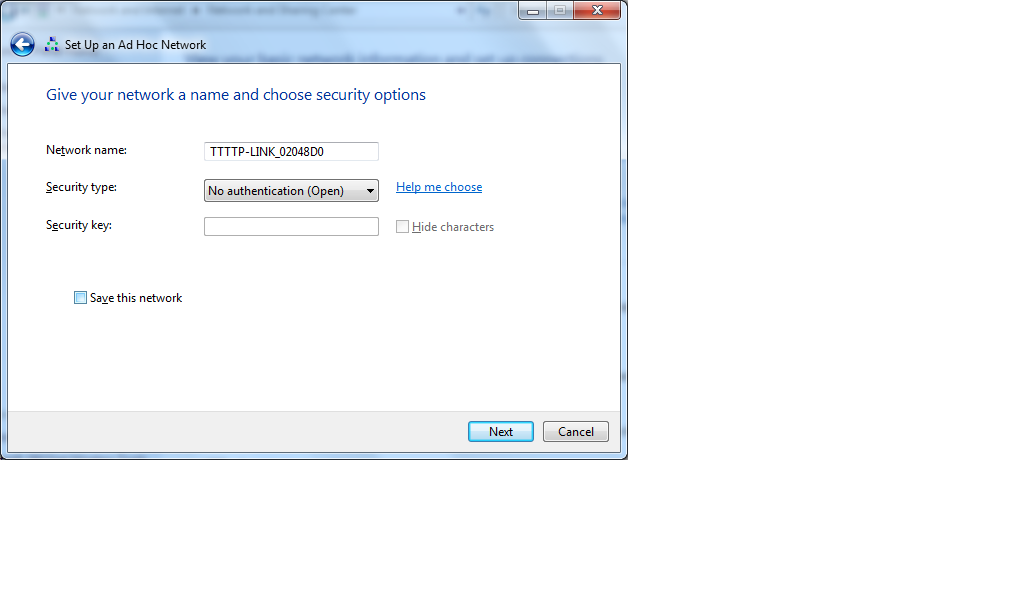

to perform first time config I am doing following step :
1. Run the application on device
2. Create a Ad Hoc connection on Win 7 PC (See the attachement for connection detail)
3.when I start connection then host will never come out of while loop.
hert I am making connection name as per the docuementation :
prefix-lenght-TP-LINK_last 6 digit of MAC ID- 0
Before doing First time config  I have not created any user profile
Please let me know what needs to be done to complete the FIrst Time Config

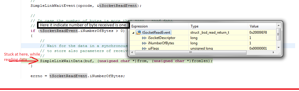

  • Your list of things you've done looks fine, and it sounds like you're briefly getting the right outcome from your code. It's unusual that the code gets stuck like that.
    A few questions that may help point you in the right direction:
    1) Do you know where in simplelinkwaitdata the code gets stuck?
    2) Are you still receiving data over SPI from the CC3000?
    3) Or is the data getting lost somewhere in the HCI?

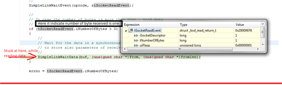

  • As I said, Initially for few bytes(1- 100), sometime CC3000 receives 1 byte and then get stuck and sometime receives more then 100 bytes and then stuck, See the attached snap shot for the location the controller get stuck
    So it get the length information correctly but when it go for reading a data then it get hang an will never come out of the loop and infinitely look for
    tSLInformation.usEventOrDataReceived to get set in event_handler.c.
    So I am not sure waht needs to done to get it working, cause there is so many APIs are working but some of them are giving a problem :

  • Yes, the code is indeed stuck in SimpleLinkWaitData() - my question is regarding where that code is stuck. Looking at the SimpleLinkWaitData() function, you'll notice it calls hci_event_handler(). Where in hci_event_handler is this code getting stuck? It may give us a clue as to the cause for this erroneous behavior.
    Because the APIs are only sometimes having issues, I am lead to believe that this is an issue with the code port onto the host Freescale device, and not necessarily a CC3000 issue. I would recommend reading our CC3000 Host Programming Guide (http://processors.wiki.ti.com/index.php/CC3000_Host_Programming_Guide) to get a better understanding of how these APIs should interact with one another. This understanding will be key to figuring out what part of your ported code is not functioning correctly.
  • Oh ok I Will again check the porting of host driver in our source code and see if I can trace any possible  cause of this behaviour of CC3000 with our controller.
    But the only concern of mine is why it is behaving correctly for send API and some of the socket API , also I can able to delete the profile and can create the profile successfully.
    Please check at your end if anyone has seen the similar behaviour meanwhile I am looking into the porting guide again.
    Also I wanted to share one thing regarding spipausespi and spiresumespi.
    in the above function I am disabling and enabling the interrupt (WL_IRQ). Is there any problem in doing this?
    Also regarding the location at which controller is hanging while doing recv, as I already mention it is in hci_event_handler function, where code will check for tSLInformation.usEventorDataReceived to get set.
    but this flag is never getting set, so it will remain in while(1) loop.
