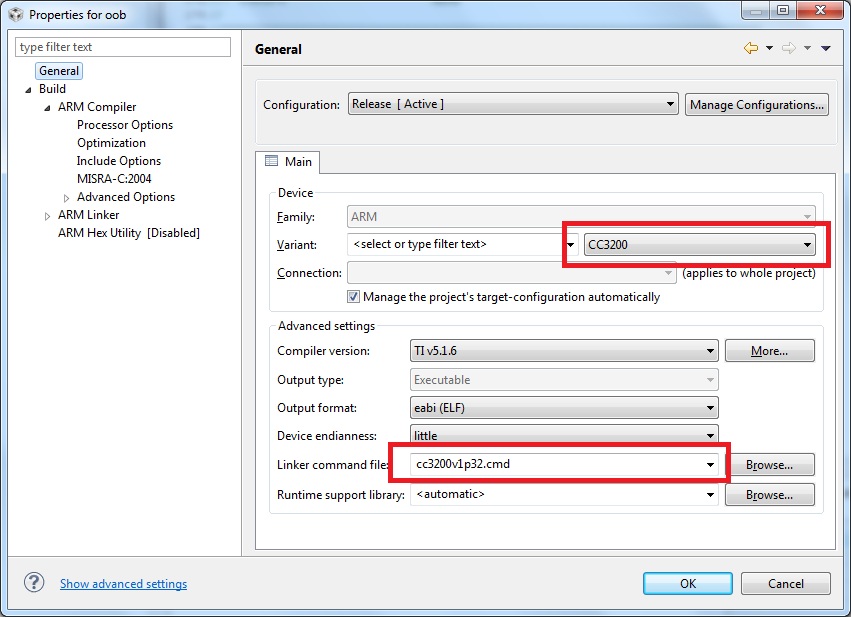

    I seem to have the same problem, i.e., the program works in the debug mode through CCS but when I flash the binary through Uniflash it doesn't work at all. I've read similar question on this forum so I've double checked the flashing procedure but nothing seems to help so far. In summary:
    1. Program runs fine in the debug mode through CCS.
    2. Flashing the binary seems to have no problem.
    3. Tried formatting the device, with nothing checked and while selecting the 1MB option. Doesn't help.
    4. Tried re-installing the service pack, seems to be installing properly, but it doesn't help either.
    5. OOB example binaries work fine. But when I recompile the examples in CCS and flash the new binary, it doesn't work.
    From all this it seems to be a problem with the build configuration in CCS which is generating this binary.

    5) Looking at code size, I assume that you have modified the code. Can you confirm that below highlighted settings are intact.
      This issue is still not fixed.  The SDK examples flash and run fine, but there must be something about my application code which is causing problems. Not even the serial port seems to operate. This is puzzling since it is a very simple program which just uses the DMA and interrupts to generate a PWM signal.  I am going to try to graft it onto one of the example programs to see if I can learn anything.
  • Hi Mike,
    1. Can you pls confirm from the MAP file that the vector table (g_pfnVectors) got place properly at 0x2000_4000.
    2. If you are using UART pls confirm that you have enabled the UART peripheral using MAP_PRCMPeripheralClkEnable() from your code. When you are debugging with SOP2 mounted the UART will be by default enable but with no SOP mounted UART needs to enabled explicitly.
    Thanks and Regards,
    Praveen
  • Hi Praveen,
      Yes, I can confirm that g_pfnVectors have been placed at 0x2000_4000.  I did not have the MAP_PRCMPeripheralClkEnable call in my code, as I was relying on InitTerm().  After receiving your last message, however, I did add MAP_PRCMPeripheralClkEnable(PRCM_UARTA0, PRCM_RUN_MODE_CLK);  to my code, but it had no effect.  The code still runs fine when loaded with CCS debug, but does nothing detectable at all when the .bin file is flashed to /sys/mcuimg.bin.  Again, other compiled projects boot up fine when I flash their .bin files.  I am going to try making the code more robust and adding it to an existing project which currently boots fine when flashed.  I will also add some more UART messaging and PIO pin toggling to try to learn what is going on.
    Thanks, Mike
  • Hi Mike,
    Were you able to figure out the issue? If not is it possible for you to share the source project or the .bin file of yours so that I can recreate the issue here ?
    Thanks and Regards,
    Praveen
  • Hi Praveen,  Yes, I rebuilt the project adding my code to the httpserver example project, and then it ran fine and booted up correctly after I had burnt the .bin into the serial Flash.  I do not know why it did not work before, but something must have been amiss with the project configuration.  Thanks for your help.
