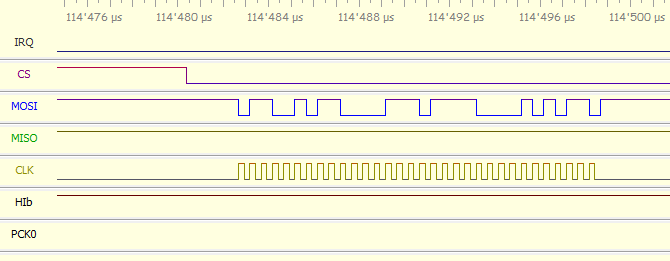

We are currently porting our CC3000 code to CC3100. In order to verify the HW and SW we connected a CC3100BOOST to our device and removed the CC3000 from our device.

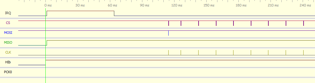

We observe now that after nHIB goes high, the IRQ goes high and after ~50ms back to low. Then the spi communication starts with a single write. This is followed by many reads until the device watchdog finally hits after some seconds.
Here you see the first SPI write:
Followed by many SP read (only clocks, no response from CC3100 for a many seconds)

  • Christoph,
    I noticed from your waveform, the SPI is not in mode 0 like the CC3100 requires...
    Aaron

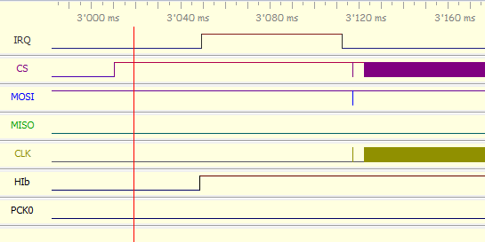

    Now the first spi write looks like this:
    but all following reads look like that: (means no resonse from CC3100)

    I captured the signal on the CC3100Boost when running the TI Radio Tool GUI and found a completely different startup behavior.
    After asserting nHib the CC3100 signals the HOST_IRQ after approx. 85ms.
    When the same CC3100Boost is connected to our own HW the startup is very fast (approx. 1 ms)
    With the effect, that the CC3100 does not deassert the HOST_IRQ after receiving the Sync Word. With the effect that MISO is always low.

  • SPI Test succeeded finally.
    Our problem was that we had a CC3000 in parallel to a CC3100. We expected the CC3000 to be silent because of its SS pulled to high. This is evidently wrong because the SS only affects the SPI lines but not the Host IRQ.
    The nHIB on CC3100 was the Wifi_EN on CC3000.
    The HOST_IRQ was then driven high by CC3000.
    sl_Start(NULL, NULL, NULL) works now!
