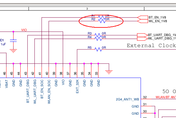

  • Hi Gigi Joseph,
    Here we are facing an issue with WLAN_EN_SOC pin at WL1835 .
    If I remove the 0 ohm resistor between WL_EN_1V8 and WLAN_EN_SOC, then I am getting proper 1.8V at WL_EN_1V8 pin.
    If I connected the 0 ohm resistor , the voltage drop is happening at WL_EN_1V8, we are getting 0.95V.
    Here I am attaching the image for reference, and 0 ohm resistor is R2, which is in circle.
    ~ Bhaskar
  • Hi Bhaskar,
    Need to understand:
    1. What else connected on the line.
    2. Have you connected the enble to the correct pin number (can be checked by module ds)
    Gigi Joseph.

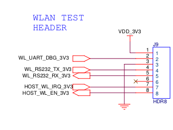

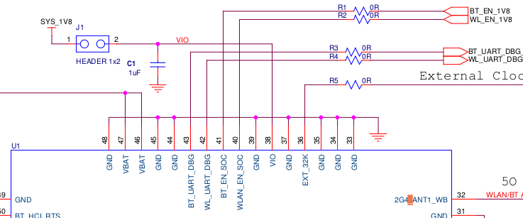

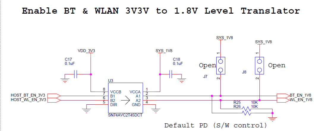

  • Dear Gigi Joseph,
    Here I am sharing the connected lines to WL_ENABLE.
    I am connecting the GPIO pin proerly to HOST_WL_EN_3V3 ( 8 pin of j9 ),
    Then It is going to 3V3V to 1.8V Level Translator.
    At pin Number 3 of U3, I am getting the 1.8V If that R2 (0 ohm) resister removed as i told you before.
    Then this WL_EN_1V8 is going directly to WL1835 MOD.
    Please let me know, where i am doing wrong.
    If you want, I will share full schematic of my WL1385 Eval module.
    ~ Bhaskar
  • Hi Bhaskar,
    Please try to remove the pull downs and check.
    Gigi Joseph.
  • Dear Gigi Joseph,
    We have tried that too, Same result.
    ~ Bhaskar

  • Hi Bhaskar,
    Please see the below response I received internally.
    There is a dedicated directional LS for the enable lines.
    What is the voltage on B2?
    If the resistor is removed and there is 3.3V on pin 6 of U3 there is no way that there is no 1.8V on pin A2
    Gigi Joseph
  • Hello Gigi Joseph,
    If LS means Level Shifter, we are using same LS which is used by TI EVM Module. We have taken reference from TI.
    The voltage at B2 is 3.3V, which is coming from GPIO Pin.
    We are getting 1.8V on pin A2, If we removed the 0 ohm resister at WL1835MOD, as i shared before.
    ~ Bhaskar
    Several more clarifications:
    Is it possible to remove the LS and the pull down resistor and drive externally 1.8v(using the jumper) - is there a voltage drop?
    Is it only one board or several?
    Can you please measure the resistance to ground on the line once the 0R removed from the module side?
    Alexey
  • Hello Alexey &  Gigi Joseph,
    After remounting the WL1835 and LS properly, Now I am getting proper voltage levels.
    and sdio card also got detected.
