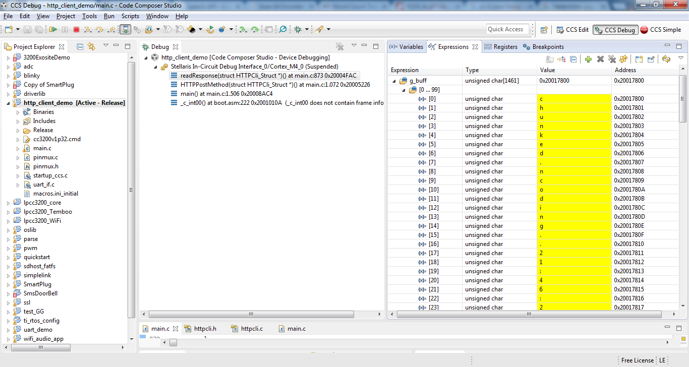

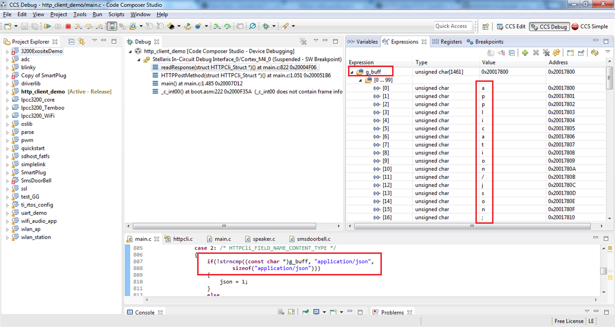

2/ the result after i debugged the code.
why after this line
if(!strncmp((const char *)g_buff, "application/json",
sizeof("application/json")))
the result is json = 0
In the second picture, the g_buff contains application/json; . Why json = 0

    Above code is application/server specific. It depend upon what type of content server support. In SDK example we are expecting server always will send JSON data, if it's it other than JSON we setting flag "json=0" to ignore the HTTP body. Please modify above code as per your need.
    Tuan Khoa Nguyen said:
    I tested with Postma and it is true that it is not json. Can only be read by XML type , HTML type , Text type . But i still wonder why json = 0
    As above we mentioned it's just a flag to ignore data other JSON in our case. It's depend upon your server. If your server send XML data then use XML parser. To determine what type of content is there, check HTTPCli_FIELD_NAME_CONTENT_TYPE header as shown in example code.
    For example:
    case 2: /* HTTPCli_FIELD_NAME_CONTENT_TYPE */
    	if(!strncmp((const char *)g_buff, "application/json", sizeof("application/json")))
    		// It's json data
    		json = 1;
    	else if(!strncmp((const char *)g_buff, "application/text", sizeof("application/json")))
    		// It's text data
    		text = 1;
    	else if(!strncmp((const char *)g_buff, "application/xml", sizeof("application/json")))
    		// It's xml data
    		xml = 1;
    break;

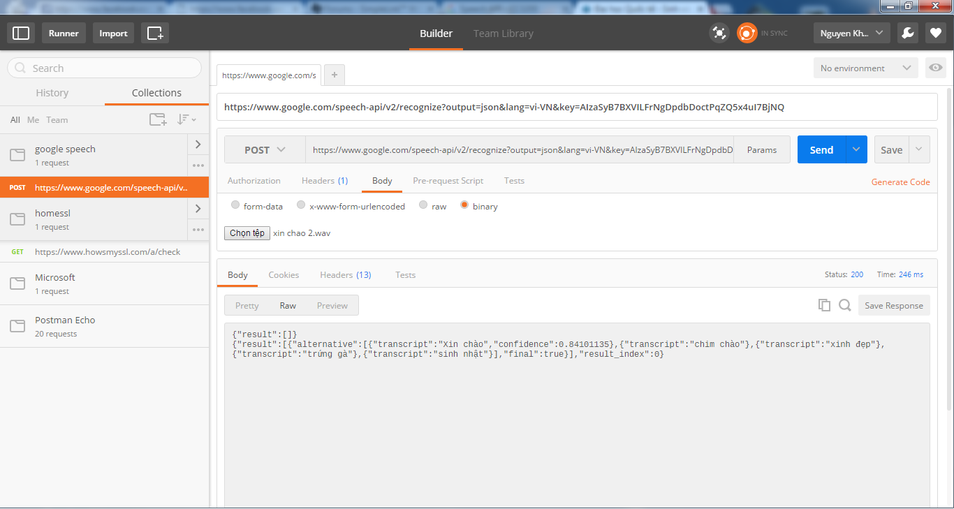

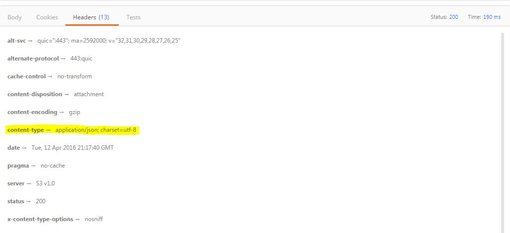

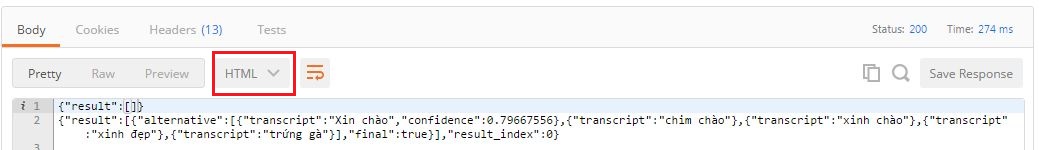

    2/ after i tested with postman, the content type is truly application/json
    the truly reponse is like this
    {"result":[]}
    {"result":[{"alternative":[{"transcript":"chào","confidence":0.70181781},{"transcript":"Cha"},{"transcript":"dạ"},{"transcript":"trẻ"}],"final":true}],"result_index":0}
    It has 2 result. It means 2 json data in reponse data
    So that why the postman cannot show it in json type

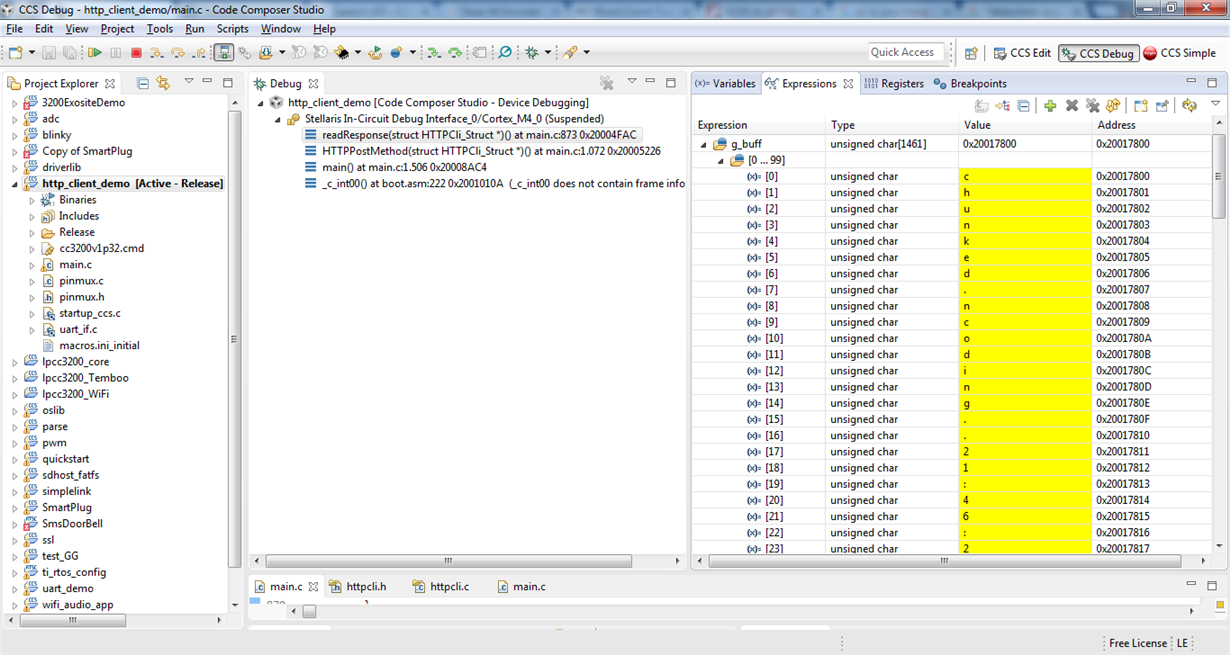

    I think that also is the reason for ccs  determines wrong content-type and can't find the reponse body. Or CC3200 can't read utf-8 type ?
    The g_buff  always contains " application/json "
    after that g_buff  = " chunked.ncoding..21:46:29.GMT8".   I don't know where g_buff have that data. And moreflag = NULL
    Even i use HTTPCli_readRawResponseBody ,I can't find where the reponse body was stored .
    So that i can't separate 2 json reuslt

    Can not comment on  this as we don't know how postman work. It will be better if you post this query in postman forum.
    No, CC3200 can read utf-8 as all data in binary format. So it doesn't matter what character encoding is. It all depend upon how your implementation interpret it.

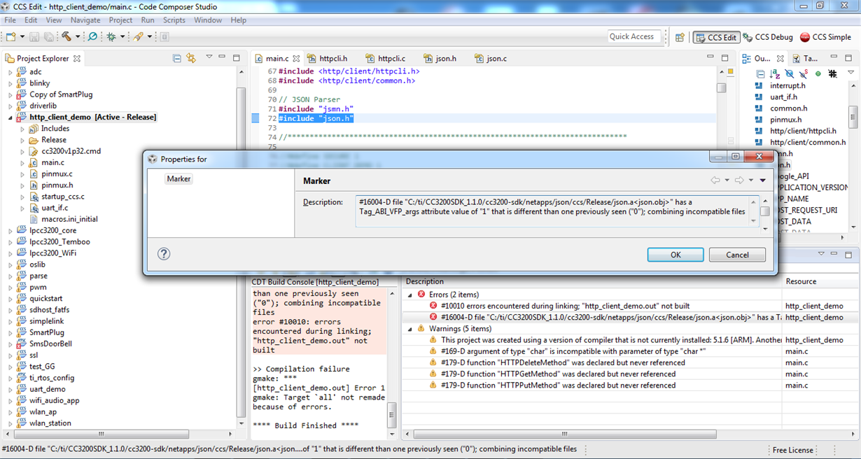

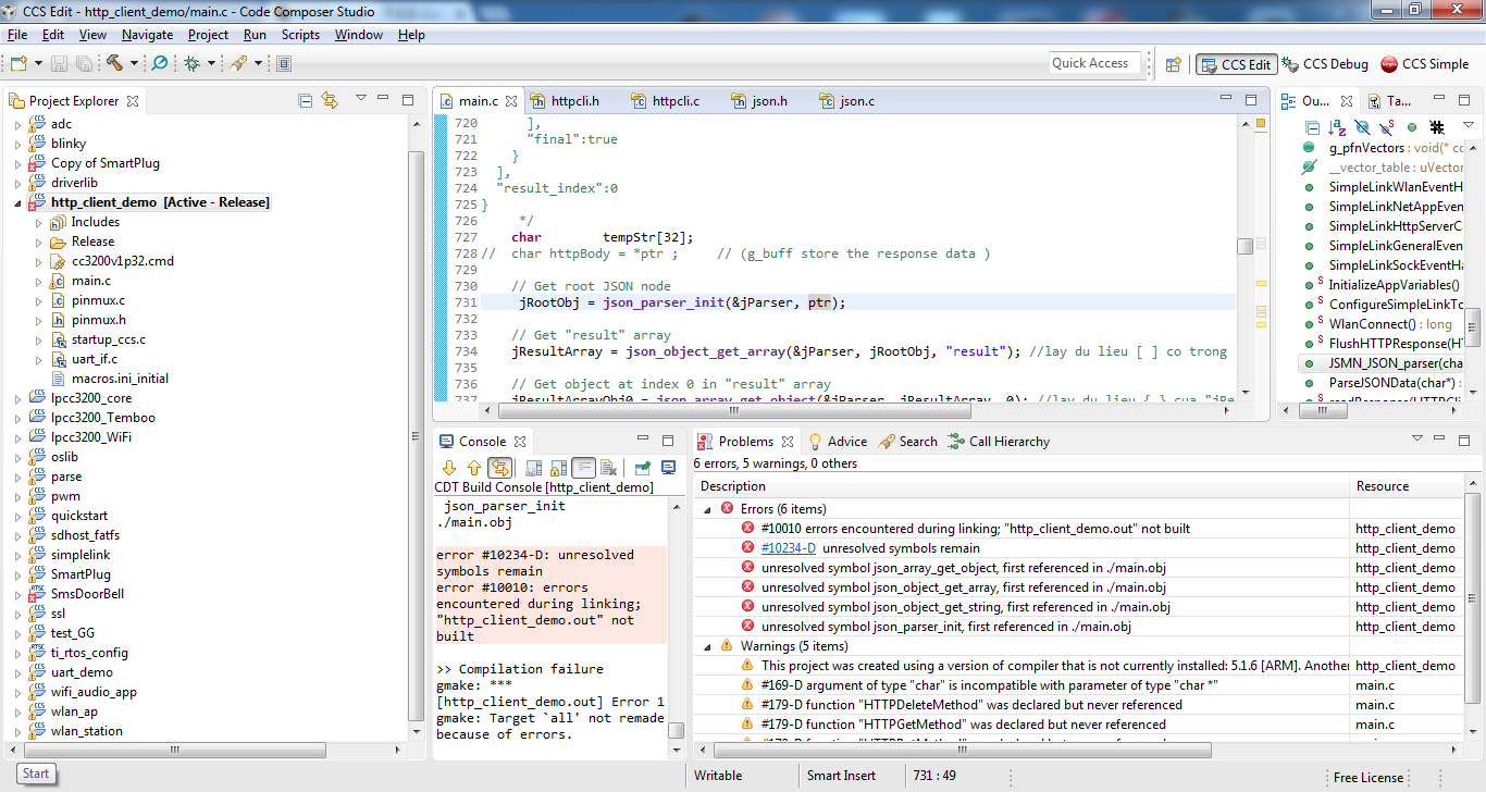

    then i add  #include "json. and build the project. These errors appear
    If i copy all folder netapps from  CC3200SDK_1.2.0 to my current SDK:  CC3200SDK_1.1.0 , these errors appear
    If i use all new CCS , SDK, Servicepack , my cc3200 cannot connect to my AP
    If i change CC3200_SDK_ROOT  CC3200SDK_1.1.0 to CC3200SDK_1.2.0,  There is an error cannot open source file "provisioning_api.h" just like thist post
    what should i do.
    Did you recompiled HTTP client and json libraries again. If not, then you need to do it. Best way to add JSON wrapper layer is copy json.c and json.h to json folder.
    export the project in CCS and add json.c. To add json.c to json library project follow below steps:
    1. Go to properties.
    2. Select Add files.
    3. Browser to file location
    4. Select json.c and click on OK
    5. No re-compile the library and application

    1/ This is the response from google. I have it from many tool help send HTTP post.
    {"result":[]}
    {"result":[{"alternative":[{"transcript":"Xin chào","confidence":0.79667556},{"transcript":"chim chào"},{"transcript":"xinh chào"},{"transcript":"xinh đẹp"},{"transcript":"trứng gà"}],"final":true}],"result_index":0}
    Google doesn't send Content-Length header so i have to set   len = 1024
    I use
    bytesRead = HTTPCli_readResponseBody(httpClient, (char *)dataBuffer, len, &moreFlags);
    and dataBuffer only contains
    {"result":[]}
    I have tried calling the HTTPCli_readResponseBody function twice or HTTPCli_readRawResponseBody function
    but the dataBuffer still the same.
    It means Goolge send the response with duplicate result of recognition.
    I found a same problem in stackoverflow but they use PHP
    What should i do to deal with it  ,even i have tried calling those APIs twice and it still not work.

    this is the response header i have from Postman
    alt-svc →quic=":443"; ma=2592000; v="32,31,30,29,28,27,26,25"
    alternate-protocol →443:quic
    cache-control →no-transform
    content-disposition →attachment
    content-encoding →gzip
    content-type →application/json; charset=utf-8
    date →Wed, 20 Apr 2016 17:29:58 GMT
    pragma →no-cache
    server →S3 v1.0
    status →200
    x-content-type-options →nosniff
    x-frame-options →SAMEORIGIN
    x-xss-protection →1; mode=block
    In the previous picture, in CCS debug you can see the yellow highlight:  Chucked encode
    So i don't know it was a gzip encode type or a Chucked encode type .
    We asked about "Transfer-Encoding" not about "Content-Encoding". From image seems like you are receiving chunked data.

    With those infomations, I use Postman send POST request which contains binary data in the body
    This is all that I know for now.

    1/  It's weird. My Postman still works fine.
    Did you choose binary tab in body and open "xin chao 2.wav" ? or ?

    2/ I combined project http_demo and wifi_ audio_app
    I have already included "json.h"  but it stil gets errors :
    unresolved symbol json_array_get_object, first referenced in ./main.obj
    unresolved symbol json_object_get_string, first referenced in ./main.obj
    If i copy Json.c and json.h into my project. it gets errors :
    unresolved symbol jsmn_init, first referenced in ./json.obj
    combine.rar
    Would you mind helping me.
    Thank you and regards,
    Khoa
  • Hi Khoa,
    1/ Is it right if i write
    #define postData (unsigned char*)(pRecordBuffer->pucReadPtr)
    Why defining as macro, you can directly use it. Also keep in mind to update pucReadPtr value once you read the data.
    You need to add jsmn.c and jsmn.h also.
