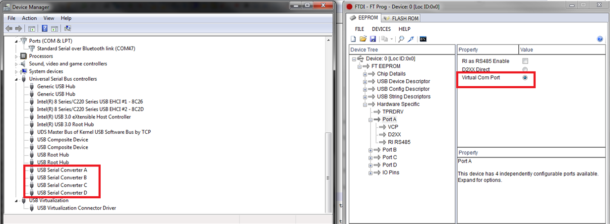

I have problem with FTDI after flash. I have a same result with this topic:
e2e.ti.com/.../353891
the device manager detect multiple, USB Serial Converter & USB serial Port , USB Serial port detected if i change the port A from Hardware spesific FTDI Prog to D2xxx Direct.. same with topic above, i follow the instruction from
processors.wiki.ti.com/.../CC31xx_&_CC32xx_FTDI_Flashing
before this, my device manager detect same with this pict:
e2e.ti.com/.../image.jpg
I dont know why, because after im format using uniflash the driver not change to UART so i  read this topic:
e2e.ti.com/.../355183
this topic say to flash the FTDI if the device manager detect 4 COM.
how i resolve this problem? where i can find the template FTDI for rollback driver CC31xxBOOST to normal.?

  • Thanks for reply Shlomi,
    Im attach the result after using template  , the driver detect USB Serial Converter, not CC3100BP PORT, this problem ? because i can,t format with uniflash with this driver.
    Arief,
  • Few things I would like you to try:
    1. Can you send a picture of the FT Prog when you click on the Device: 0? I want to see the right side.
    2. please make sure this is the only device connected (no other FTDI device), click the Erase Device, click on the Device: 0 and attach the picture.
    Shlomi
  • I using CC31XXEMUBOSST with CC3100MODBOOST plug on the top side. i remove CC3100MODBOOST and try again and the driver CC3100BP PORT succes.
    I try to re-flash again to make sure the problem. I follow this instruction again:
    and I have a different result if I make reset board using re-plug USB after program the result is driver USB Serial Converter, but if I reset board using Scan & parse (icon in FT Prog) after program, the result is CC3100BP succes to install.

    I mark the result, i think this problem because my driver not change to UART or etc?
    Arief
  • it looks OK now.
    You have managed to format and program service pack.
    Shlomi
