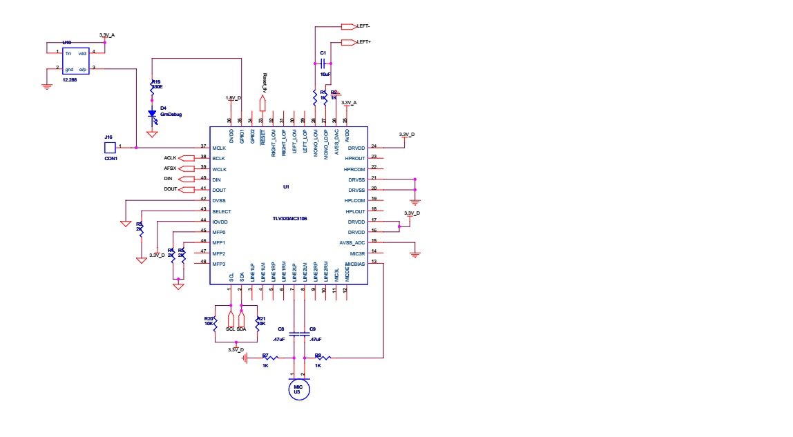

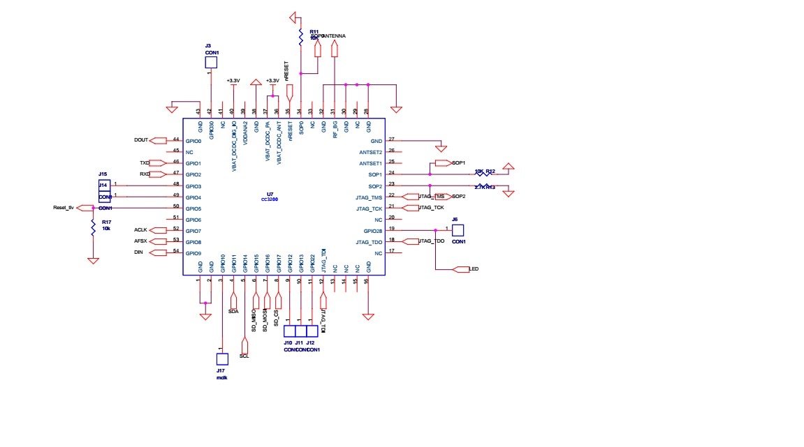

hi, i am working on tlv320aic3106 audio codec interface with cc3200 i successfully  configure the audio codec registers using I2C  then i try to read I2S data from audio codec but the I2S handler cannot read any data
I can see signals on I2S bitclock, I2S word clock and I2S data line using an oscilloscope. i am using CPU mode with out RTOS Please check below circuit and configurations.

    // Configure PIN_64 for MCASP0 D0
    MAP_PinTypeI2S(PIN_64, PIN_MODE_7); //PIN_MODE_7
    // Configure PIN_62 for MCASP0 McAFSX CLK
    MAP_PinTypeI2S(PIN_62, PIN_MODE_13);
    // Configure PIN_63 for MCASP0 wclk (sync)
    MAP_PinTypeI2S(PIN_63, PIN_MODE_7);
    // Configure PIN_50 for MCASP0 D1
    MAP_PinTypeI2S(PIN_50, PIN_MODE_6); //PIN_MODE_6
