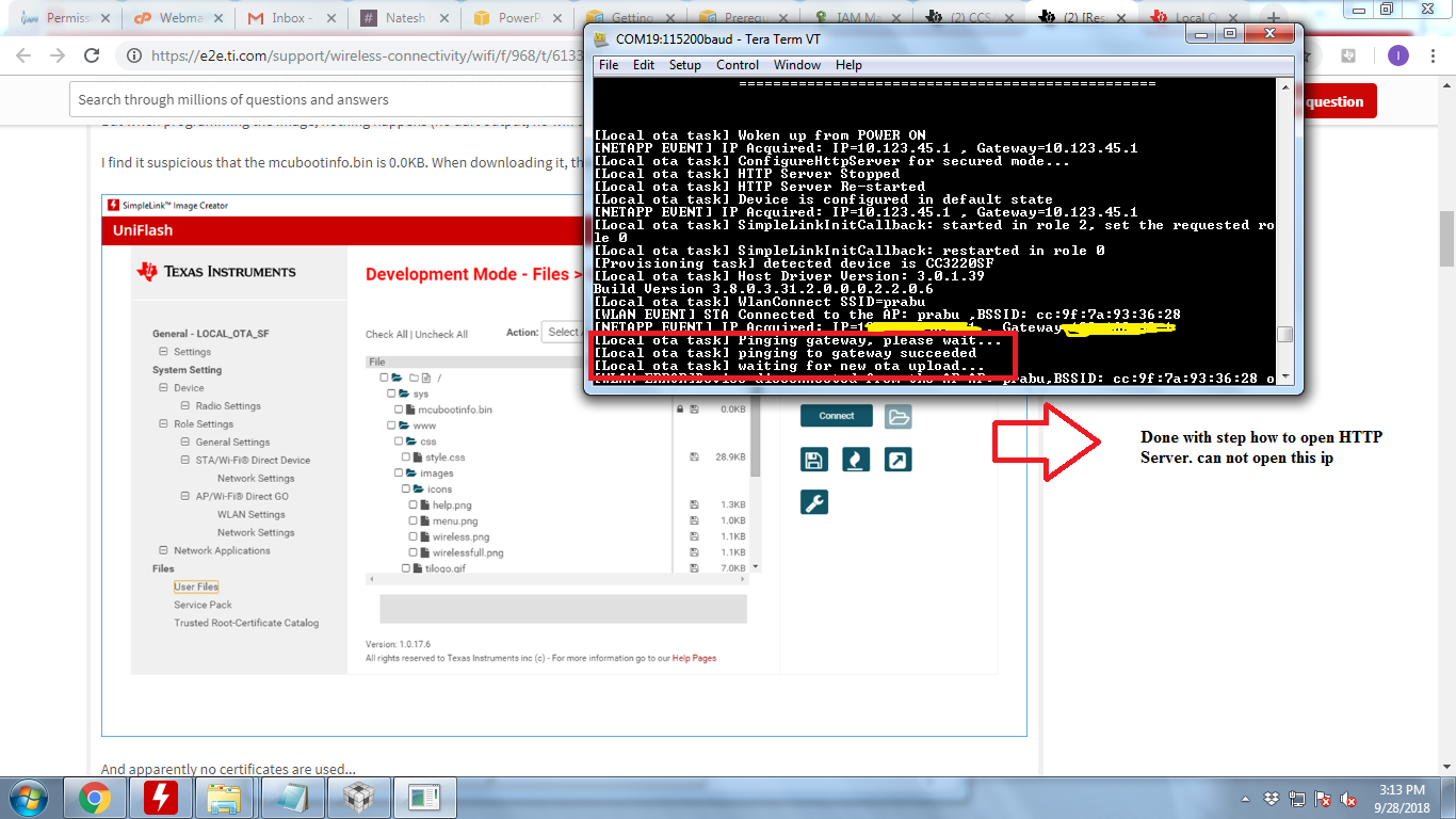

hai all,
i'am try to local ota example , i cant access the ota.html
i followed
https://e2e.ti.com/support/wireless-connectivity/wifi/f/968/t/613302
i have one question
on this steps how to access OTA.html ( in CCS program rebuild - go to debug select Bin file) or Uniflash File
can not open ota.html web page
uni flash all are file .
Uniflash background image alla are fine
major issue is how to access ota web page ...

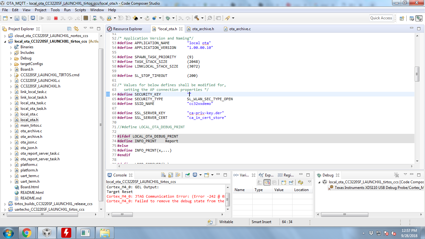

 my CCS Code is that .....
how to access the ota web page ...
thanks and regards
SELVA

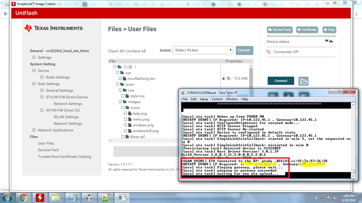

  • Hi Selva,
    You need to flash the provided Uniflash project first. The ota.html file is included with that Uniflash, and needs to be flashed onto the CC3220. Without that file, you will be unable to access ota.html through your browser.
    Once you have flashed that Uniflash project, you can just let the program run freely from reset. Then, follow the remaining steps in the local_ota readme to perform the local OTA update.

  • hai Michael,
    uniflash SDK File . Zip File Right, Then next flash to local OTA project Bin File ...
    example:
    C:\ti\simplelink_cc32xx_sdk_2_20_01_00\examples\rtos\CC3220SF_LAUNCHXL\demos\local_ota\uniflash\cc3220sf_local_ota_tirtos\cc3220sf_local_ota_tirtos
    any other change this file ...
    then, any other change mcpbootinfo.bin file  or project local ota project bin file upload or not
    please tel us clearly
    i try to this method but not working
    thanks
    SELVA

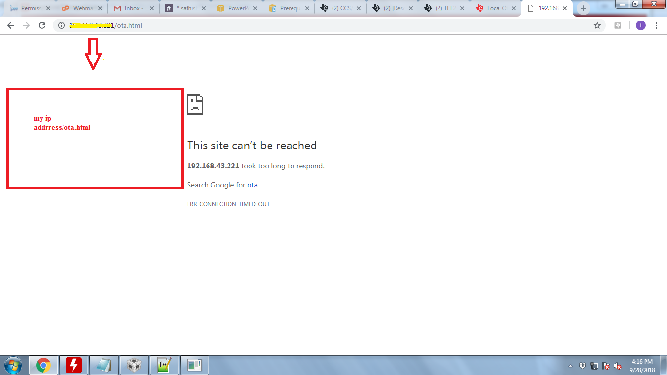

  • hai,
    how to resolve this issue ..
    i try all method , but ota.html page not open.... how to open URL ------> ipaddress/ota.html
    or CC32XX.ipaddress/ota.html
    SELVA
