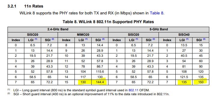

WL1837MOD: Antenna selection for the WL1837MOD
Part Number: WL1837MOD
Since the WL1837MOD advertises up to 40Mhz SISO for the 2.4Ghz, versus only 20MHz MIMO operation for the 2.4GHz, isn't it a wash in terms of data throughput?  Is there are document which describes the anticipated throughput or bitrate in the different modes of operation?
