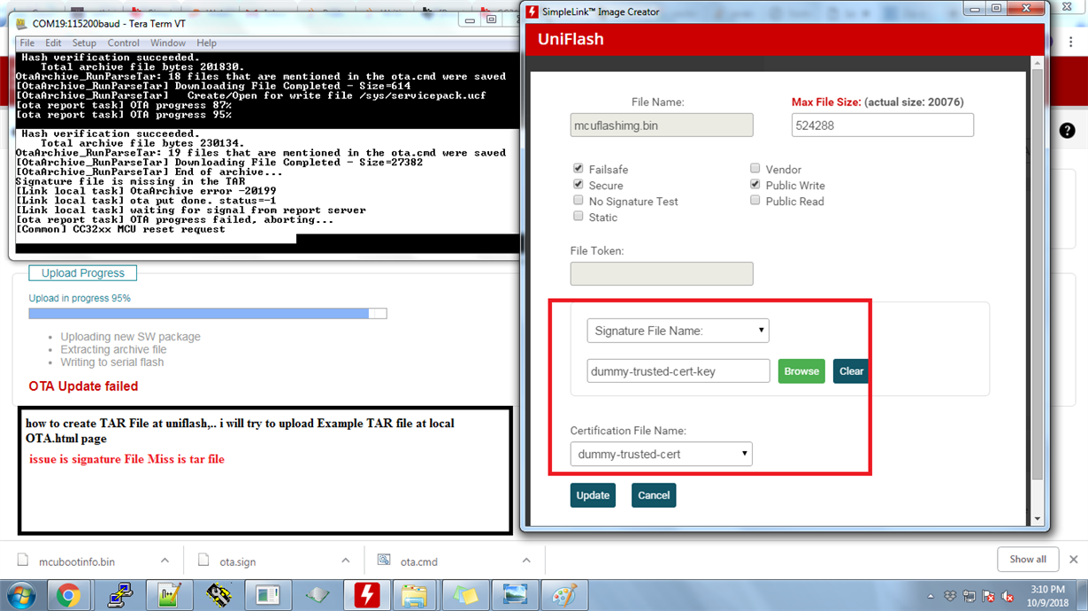

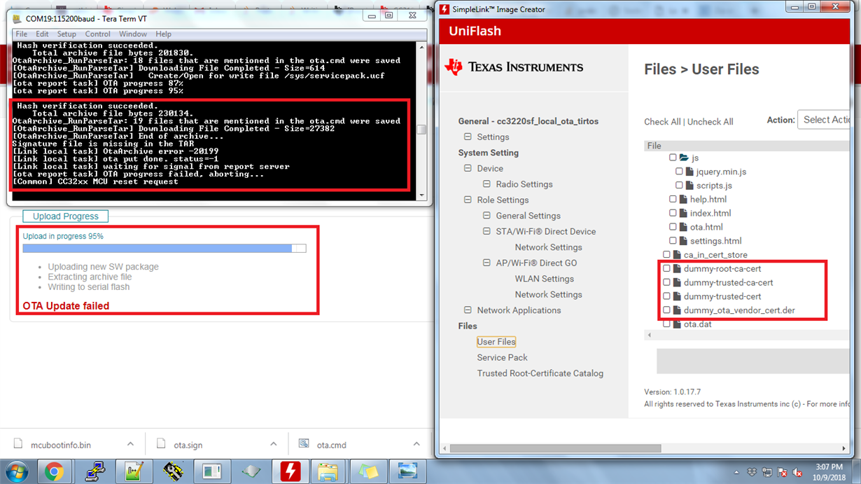

i am working with CC3220SF Local OTA
Following the guide of the example:
local OTA.HTM Page access is success fully .. but TAR File Signature Missing Error coming   .. How to solve this issue
and using uniflash create the OTA TAR File..
 all signature file Followed by New update SDK only
i followed
https://e2e.ti.com/support/wireless-connectivity/wifi/f/968/t/613302
but can not update webpage.. (OTA.Sign File not generate at TAR File)
how to resolve this issue. please tel us step by step process ..
Thanks and Regards
SELVA
  • Hi Selva,
    Which Uniflash version are you using?
    In the latest version, once you try "Create OTA" you need to select a key to sign the image.
    Have you done that?
    You should then choose the private key (e.g. "dummy_ota_vendor_key.der" if you use the playground certificate catalog) that corresponds to the certificate you put in flash ("dummy_ota_vendor_cert.der").
    For more details, please refer to (see the "Preparing An OTA Image" section).
    Br,
    Kobi
