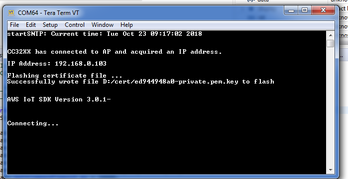

  • Hello Kobi,
    Right now i have started implementing example application (subscribe_publish_sample_CC3220SF_LAUNCHXL_tirtos_ccs).
    I have created the required certificates in AWS account according to AWS developer setup.
    below is the screen shot of the output i got after the step
    Connecting .... it is stuck there what might be the issue?

  • Hi Sanath Rai,
    Which version of the AWS plugin are you using? You may not be building against the correct version of the SimpleLink CC32xx SDK. You can check your AWS Plugin's Release Notes, and under dependencies it lists which version of the SimpleLink SDK you should be using. Try building against the correct version to see if your issue is solved.
    Hope that helps,
    Gerardo

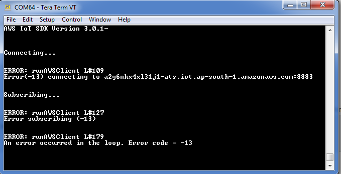

  • Hi Gerardo,
    AWS IOT Plugin is 2.0.0.09
    Simplelink CC32xx SDK 2.30.0.05
    i also tried with  Simplelink CC32xx SDK 2.10.0.04
    but with Simplelink CC32xx SDK 2.10.0.04 below is the isuue i am getting
    Sanath Rai
  • Hi Gerardo,
    Thank you for suggestion.
    I went through the release note The SDK plugin compatible was 2.20.0.10
    But Still it is getting stuck at "connecting"
    Sanath Rai

  • Sanath Rai,
    Your certificates are incorrect; it looks like you are confusing where the certs are being stored in your PC with where they need to be stored on the device. You currently have the paths to where they are on your PC which is incorrect, these have to be restored to their original values.
    Next, for the C array that contains the actual content of the certificates, you will need to add “\r\n” to each line. This is really easy to mess up, so I would suggest you look at the QuickStart Guide’s section titled “Update the Example to use the certificates”, there it will show you an example of what this should look like.
    BR,
    Gerardo
  • Hello Gerardo,
    Thank you Gerardo.That was the issue.i flashed certificates using Uniflash and then using CCS i debugged the application .it worked.
