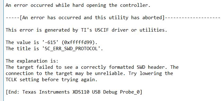

    The error I get when trying to connect via SWD is
    Jan

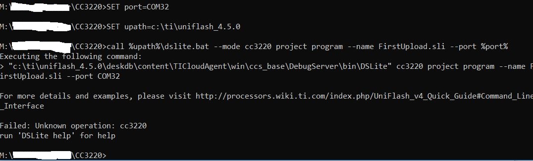

    My recommendation is to prepare image with devemopelmet mode in Uniflash GUI and that use Uniflash CLI to upload it. I am not sure if at new versions of Uniflash GUI is possible to select COM port. With some older versions of 4.x this was not possible and it was requred to use CLI version. Uniflash CLI code tested with version 4.2 (Uniflash project with name "test"):
    SET port=COM3
    SET upath=c:\ti\uniflash_4.0
    call %upath%\dslite.bat --mode cc3220 project program --name test --port %port%
    In case of that you have CC3220 LaunchPad, you should check if error -615 is returned in case of device is in production mode. Without testing I am not able guarantee that this error is not returned in case of connection issue with SWD. Alternately you can search at e2e forum. I expect that you find more threads releated to error -615 with CC3220.
    BTW ... SOP mode [ 0 1 0 ] is for a JTAG (4-wires) not for a SWD. Just to be sure...

    - I got the same error (-615) when programming the CC3220SF LP in production mode. But the same error I also get when SOP is set to [0 1 0] as this is for JTAG(4-wires) and not for SWD. So there can be more than one reason why I get this error.

    To be able connect by Uniflash you need to use SOP mode [ 1 0 0 ] or [ 0 1 0 ] (2 1 0). Before entering to bootloader for flashing image is a device reset mandatory.
    Are you able execute your production image at CC3220 LaunchPad? Can you simulate connection with your LaunchPad with Silab chip? It may to be reasonable to simulate programming with LaunchPad and after you will be able do that continue to your hardware.
    Command above I use with Uniflash version 4.2. As I remember I had some issue with newer versions of Uniflash. But I don't know real reason, because I don't investigate that yet.
    BTW ... name parameters is a name of Uniflash project not a name of .sli file.

    After downloading Uniflash 4.2, I got some response using the CLI command that you gave me. It looks like the interface has changed somewhat in version 4.5. However, starting with the Launchpad, I am still not able to get the device up and running after programming the device with dslite running Uniflash4.2. I get the following error message
    INFO:root:The device type defined in the project settings differs from the type of the actual connected device
    Wrong device type, press ENTER to contine or CTRL-C to abort
    Trying to get the same file structure as I got to work in V4.5, it complains about a signature file name being empty when trying to program from Uniflash.
    So trying to program the Launchpad from 4.2 did not get me any further.
