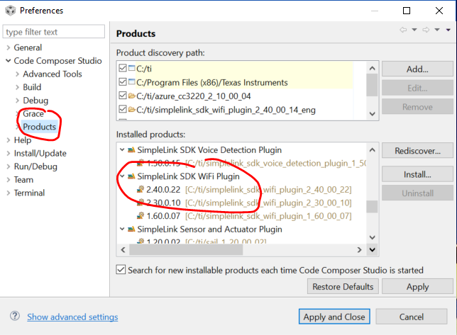

My goal is to get the CC3120BOOST to connect to my personal hotspot (either laptop or iphone). The host is CC2652R1 MCU.
However, I can't seem to find any of the plugins/SDKs associated with CC3120 on code composer studio. I have already downloaded "SIMPLELINK-SDK-WIFI-PLUGIN_2.40.00.22" on my computer but it is not showing up on code composer studio.

To make CCS recognize the Wi-Fi Plugin or any SDK, go to Window->Preferences in the top menu bar. Go to Code Composer Studio->Products and click Rediscover. If the latest Wi-Fi Plugin is still not in Installed products, you may have installed the software in a different path. Add that path to the Product discovery path and try Rediscover again.
