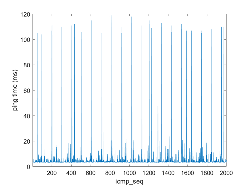

I have two Beaglebone Wireless boards set up. The first set up as an AP, the second connecting to the first. Having one ping the other results in ping times that frequently go to 110ms and 220ms.
I've found several threads reporting what appears to be the same or similar issue, with no consistent resolution:

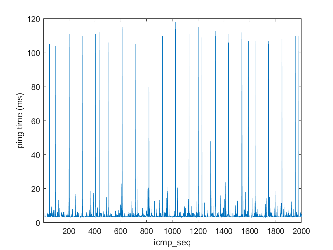

Below is the plot of response times for "ping <hostname> -i 0.1":
Note the ping times spike consistently every 100 packets, or 10 seconds.
Repro steps:
Beaglebone Black with Debian 9.5 2018-10-07 IoT available here:
beagleboard.org/latest-images
This image comes with kernel 4.14.71-ti-r80 and wl18xx-fw-4.bin version 8.9.0.0.79.
These do not resolve the issue (suggested by TI in other threads)
    iw wlan0 set power_save off
    echo 0 > /sys/kernel/debug/ieee80211/phy0/wlcore/sleep_auth
Also do not resolve
    Disabling bluetooth
    Upgrading to kernel 4.19.24 from github.com/.../linux
    Rebuilding kernel 4.19.24 with CONFIG_CFG80211_DEFAULT_PS=n
Can you please investigate?
Thank you.
  • After looking at debug messages for the wl18xx driver, it became clear that the high ping times were associated with these messages:
    [ 1848.443504] wlcore: cmd configure (47)
    Which led me to the ACX_BA_SESSION_RX_SETUP command, configured in a call to wl12xx_acx_set_ba_receiver_session(), in turn called by wl1271_op_ampdu_action().
    I patched the module to disable RX AMPDU by keeping wlvif->ba_support = false. This normalized the ping time, which now only goes up during wifi scans.
    It's intuitive that AMPDU increases latency. However, 100-200ms of added latency is huge and unexpected. Could investigate whether there's a bug hiding in the AMPDU implementation, and confirm my findings above?
    My application is latency critical and having the ability to disable AMPDU (without rebuilding the driver) would also be helpful. As is, I'll need to build a custom driver.
    Thanks.

  • Hi Saurabh,
    I did run iperf3 and throughput went down substantially, but is still good enough for my application. Of course I'd prefer the nominal throughput but 100-200ms of latency won't work for me.
    I have no experience with sniffing 802.11. I did try using wireshark with my 802.11 adapter in monitor mode, but it didn't capture management frames. Wireshark's documentation states most drivers don't forward management frames to the packet capture layer, so this might be the situation.
    If you can suggest a method to sniff BA session exchanges (perhaps with the beaglebone black wireless itself), I'd be open to trying it.
    My main goal is to ensure the driver will work appropriately. Based on the code, can you inform if my patch is disabling BA entirely, or just the driver's handling of it?

  • Hi Flavio,
    A single ping reply time is not really a good indication of anything as the system has enough time to idle, enter power save, switch to another process/thread in between pings.
    When the station does enter power save it will only wakeup for the next beacon from the AP. Hence a delay is expected.
    You can disable power save:
    and see if it makes a change.
    But in any case I strongly advise against making code changes to the drivers.
    Eyal
  • Hi Eyal,
    Setting power saving mode (iw wlan0 set power_save off) does not resolve the issue -- please see my original post for things I tried. The graph I show is for power_save = off. In general, disabling power_save and ELP helps with latency but not with this specific issue.
    I too would like to avoid a driver change, especially since I'm not aware of what TI firmware does or expects. But I need low latency too (100ms pings are not ok), so I need TI's help to determine root cause and design the correct solution.
    Flavio
  • Today I experimented with changing the wl18xx-conf.bin file by setting core.ht.rx_ba_win_size, core.ht.rx_ba_win_size and core.ht.tx_ba_tid_bitmap to 0x00 and saw the same improvement in ping latency as with modifying the driver. In other words, ping time distribution looks about the same in the two cases below:
    1) setting core.ht.rx_ba_win_size, core.ht.tx_ba_win_size and core.ht.tx_ba_tid_bitmap to 0x00, while using the stock Beaglebone Black Wireless kernel
    2) modifying the kernel module with wlvif->ba_support = false, and using the stock Beaglebone Black Wireless wl18xx-conf.bin
    I've attached the original configuration of the Beaglebone Black Wireless for your reference.
    Your advice would be appreciated.
