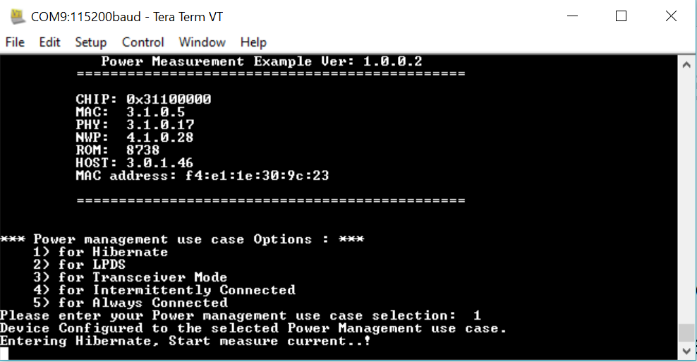

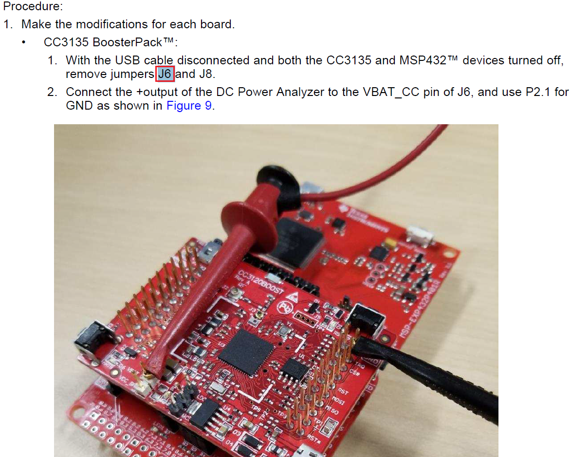

Could you provide transceiver mode parameter in power management example? The current we measured is bigger than AN http://www.ti.com/lit/an/swra594/swra594.pdf.
Test by below parameter:
number of packets per channel
1
packet size [50-1400 bytes]
50
delay between channels [in miliseconds]
5000
packet wifi rate
21
channel mask in HEX [e.g. channels 1,6,11 is 421]
1
power backoff from maximum [0-15 dB]
15
cycle period [in seconds]
5
lowest power level between cycles
2
The measured average current is 417uA, peak current is 232mA, bigger than 176mA in AN

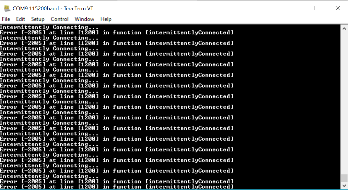

Change it to 5) for Always Connected,
Average current is 733uA, peak current is 274mA, is also bigger than 568uA and 98mA given in AN。
