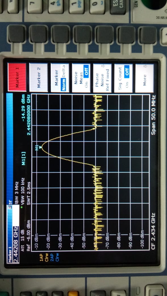

  • Hello Sudarshan,
    I have tried the following,
    calibrator wlan0 plt power_mode on
    calibrator wlan0 wl18xx_plt tune_channel 5 0 3
    calibrator wlan0 wl18xx_plt tx_tone_start 2 0 0 0
    But what I am seeing on the analyser the center-frequency as for channel-5 as 2.442GHz instead of 2.434GHz
    Please help

  • Hi Anurag,
    You are giving the following commands

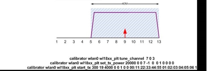

    In tune_channel you are setting the 3rd parameter as "3". This means that it is for 40MHz. You need to set this to 20MHz (option 0). Please refer to http://processors.wiki.ti.com/index.php/WL18xx_TX_Testing#TX_Tone_Test section "Tune Channels" for details.
    Since the BW is set to 40MHz, the tool is picking the lower primary channel for channel 5 and the frequency is tuned to around channel 7
    Also the Tx tone command is problematic:
    The 2nd parameter is the bin index – if they set it to 0 than the CW will be on top of the DC…
    If you want to set it to 2434MHz than you needs to set it to a different OFDM bin:  -6 x312.5KHz = LO – 1.875MHz
    Bottom-line, Please use the following command to get the desired o/p:
    calibrator wlan0 wl18xx_plt tune_channel 5 0 0
    calibrator wlan0 wl18xx_plt tx_tone_start 2 -6 0 0
